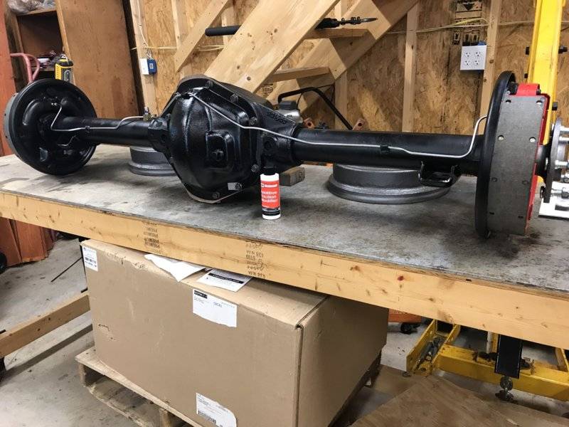

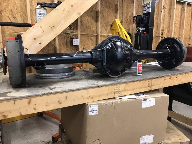

anyone have a picture of how the long line is run on a 66 dana. Got the short one. They had a mangled mess on mine when I got it. There’s one line clip on the cover, was there any other than the two on the tubes? (Under a cover boot?)
Thanks
I have some
