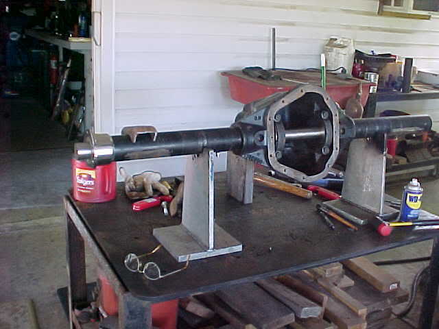

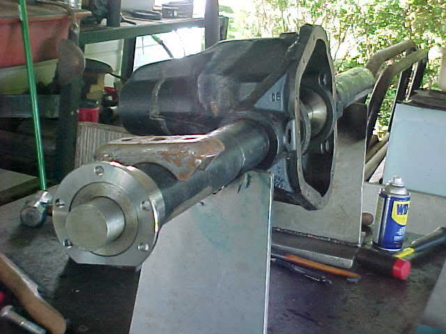

That's all I charge to narrow one and weld on new bearing housings.....25 extra for welding on the spring pads and I recommend welding the pads on first then the bearing housings. I tack everything together, take final measurements and then weld up the pads. Check the ends for straight and then weld them up.

The angle depends on the car it's going in and what the customer wants. I try to get all the info I can including suspension height before final welding. With a couple, the housing was bolted in for a final check....
I think the Glasses, the WD40, The 3# maul, The Folgers Parts container and the two BIC lighters are exactly the correct tools for this job. No, seriously. Nice shots of how to get it done without spending a fortune. thanks for the picts...
LOL! The maul is for tapping the bar in and the WD40 helps with that...and the glasses....well, I ain't no spring chicken anymore! And the lighters were probably there because one is for the BBQ pit (which is back there too) and the other is for lighting off the spray from a can of brake wash :D Gots lots of dirt daubers and wasps around here and it's cheaper and more fun than using wasp/hornet spray. And you're welcome :headbang:
