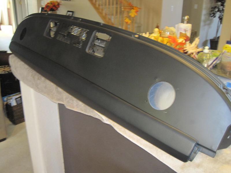

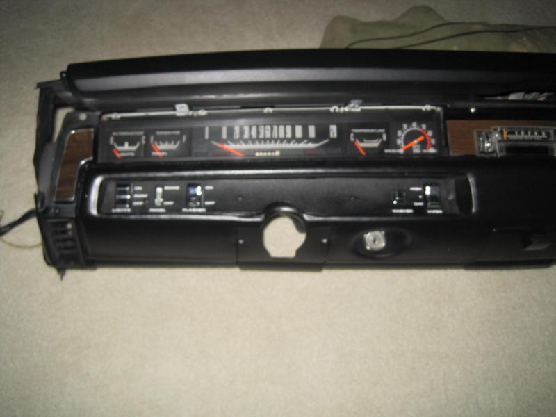

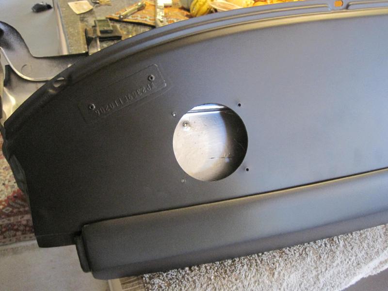

Changed my dash color from tan to black. Used John Deere Blitz Black rattle can - matte finish, durable, slight texture.
The dash pad is new
