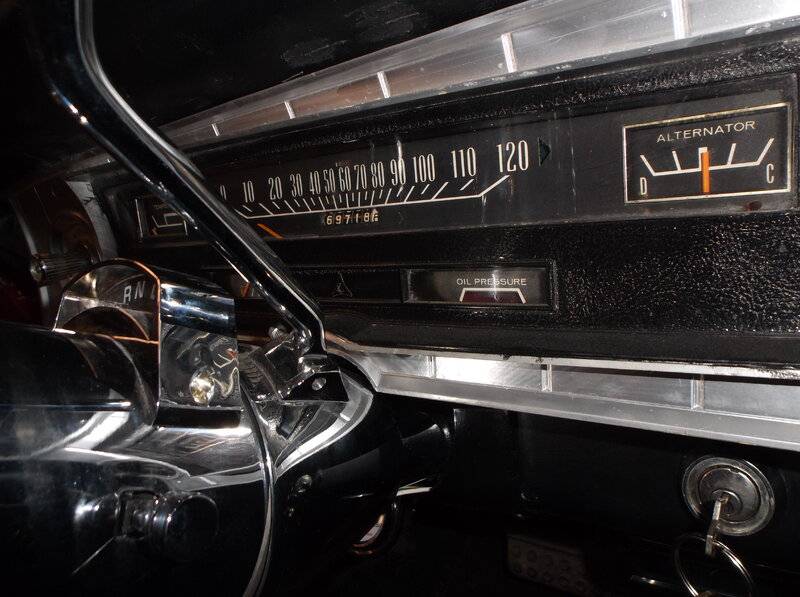

i want to buy not sell. I have a problem with my gauge cluster on my 65 Dodge Coronet none of my instruments will work alt,fuel,oil pressure, and temp gauges so i would like to try another gauge cluster. Anyone out there have one?
Check your grounding on the panel before you scrap it. Gauges work separately, so they all shouldn't go at once. There's also a circuit board to check on the backside.
