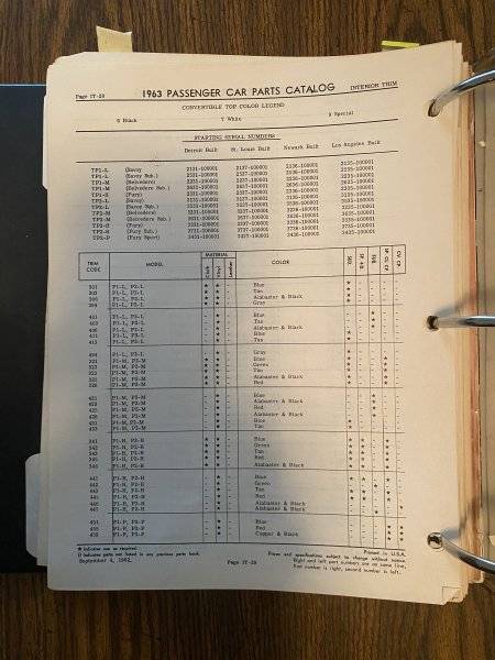

trying to identify my dash paint color. Anyone know where to find the paint code for the interior on a 1963 fury two door hardtop. The interior code is 331 for the interior.

Thank you. I will look up that code. The 331 is aqua in the factory parts manual for all models

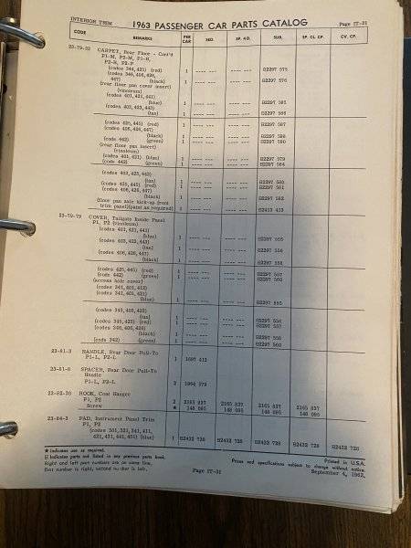

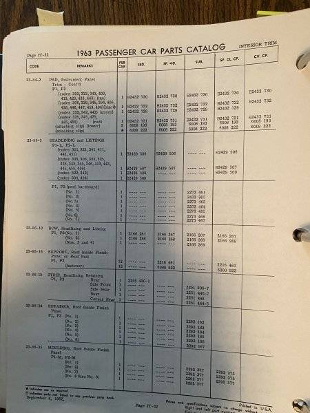

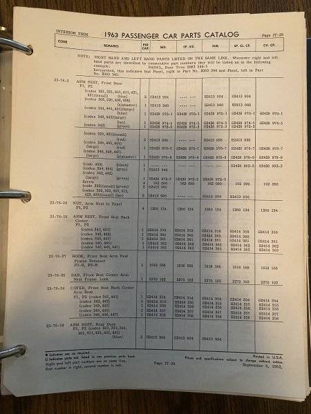

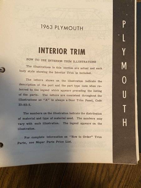

12647 was an exact match. Thank you very much. Factory parts manuals don’t always have what you need. As you can see theres a lot of data there but no paint codes. Thank you so much.
