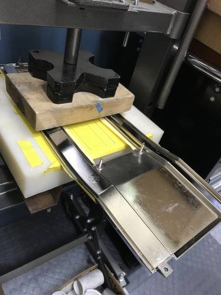

This may be a bit hare-brained but I would try to find a piece of 1/2” or thicker flat steel. Maybe something like the steel backing plates on a hydraulic press (in photo below). You might be able to come up something a bit better. Heat them up in the oven to about 150 degrees, place the piece face down on a solid, flat surface, lay a piece of paper on the part, place the heated plate(s) on top and add some more weight to get it to flatten an let it sit for awhile. Repeat a second time as necessary.
That’s not crazy
