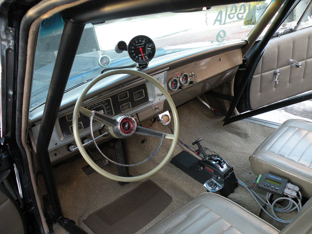

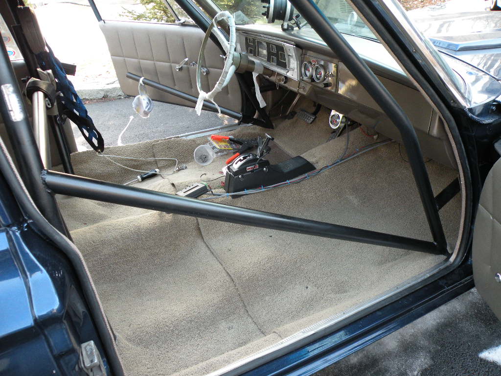

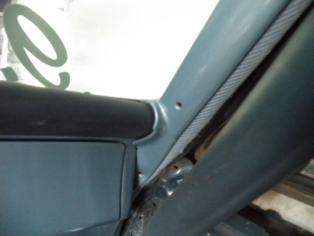

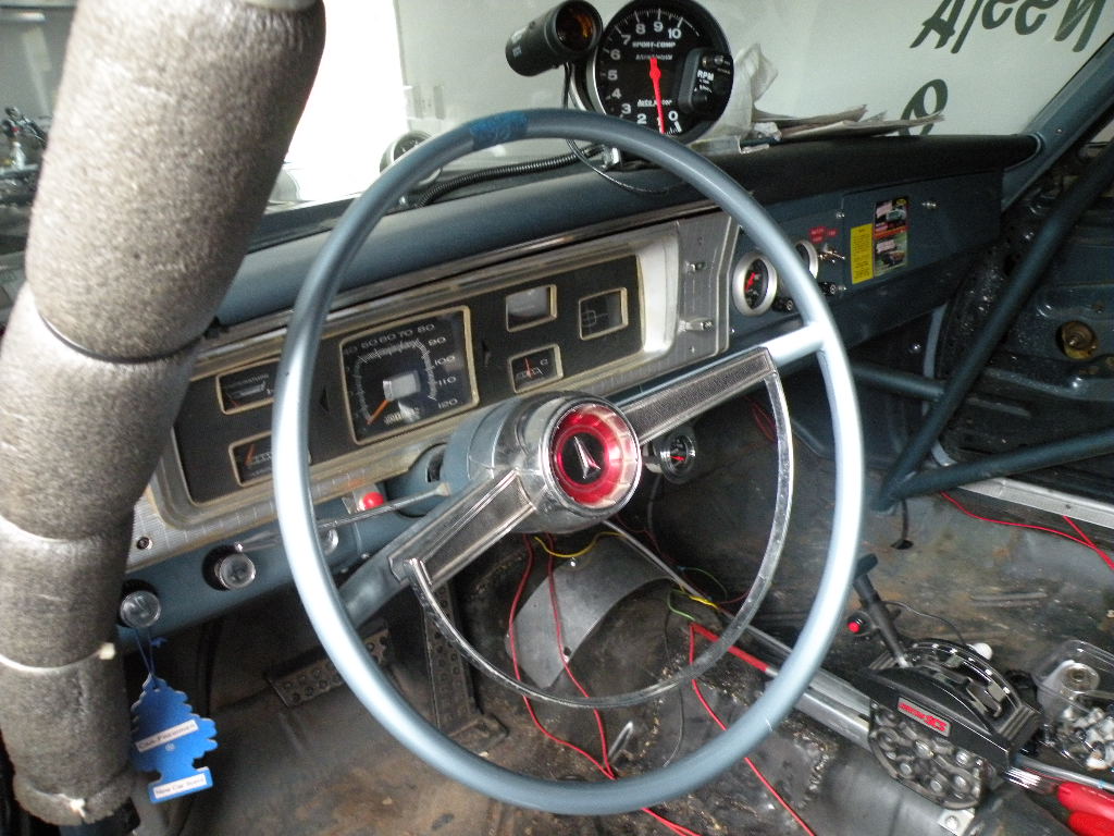

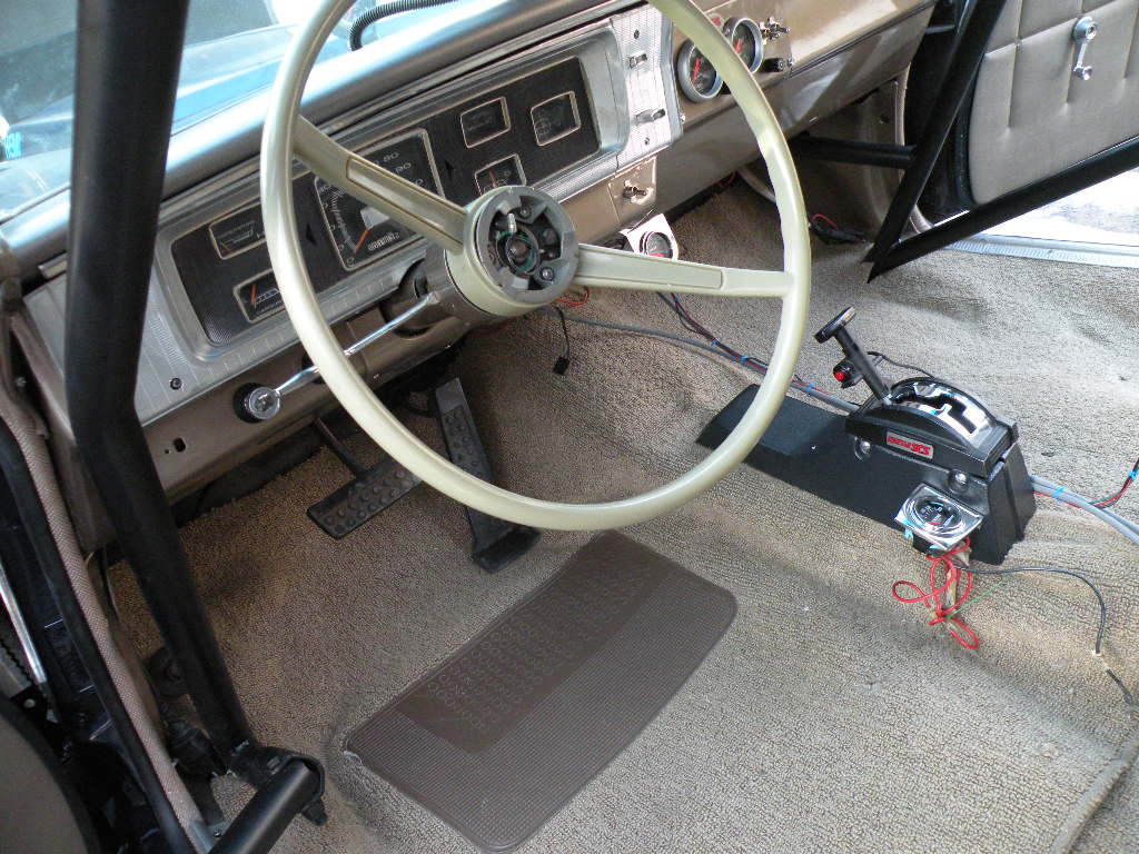

I painted cmine with the dash in place, just remove the windhield dash molding and tape up the windshield neatly. Once you put back the mo9lding, it looks perfect. Dont waste your time pulling it. Heres mine before and after being painted.

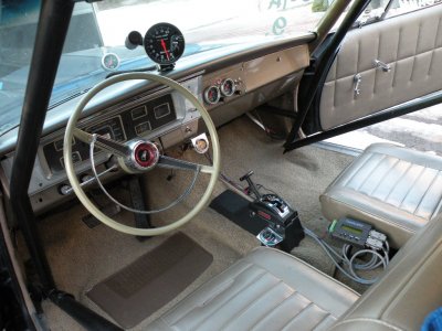

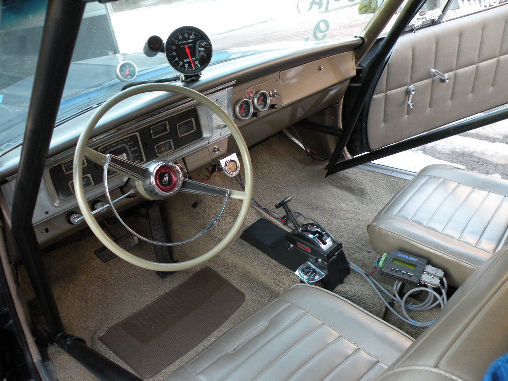

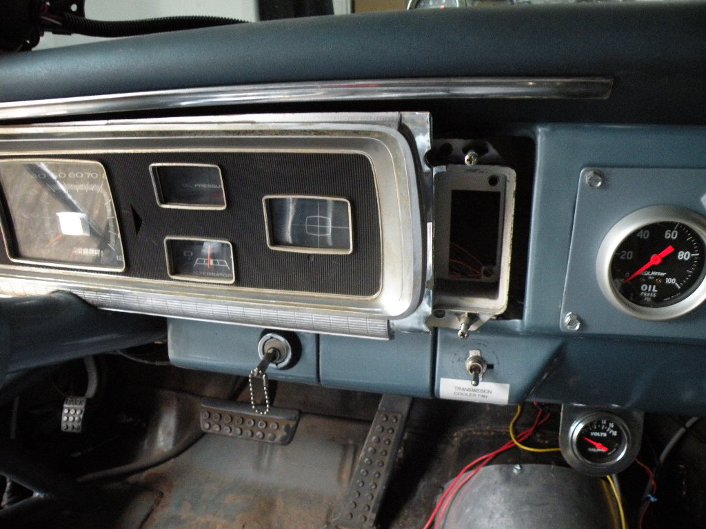

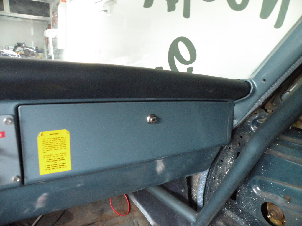

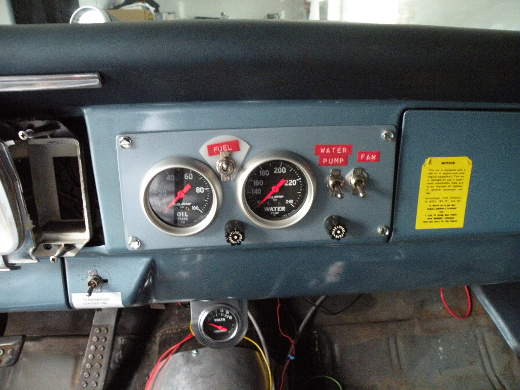

and here's after painting it the proper color.just tape everything up neatly.
