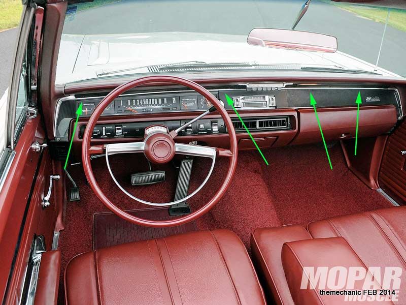

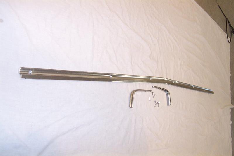

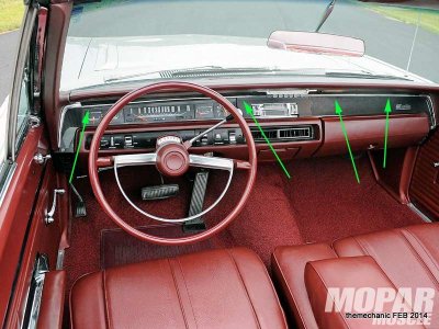

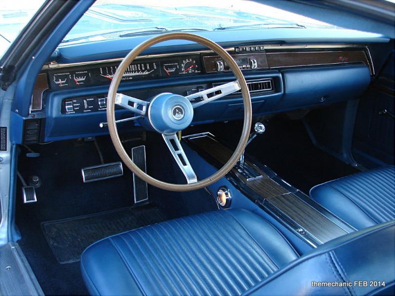

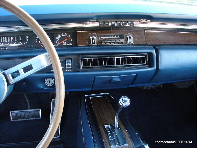

The blue car is a Coronet and the red is a Satellite. They show the trim that fills the holes in your dash. There are two stainless steel end pieces and one anodized aluminum piece that runs the length of the dash between them. There may be some body plugs for RR. Seems odd to leave open holes in the dash and not the door (reference the plug below the wing window). If you have the chromed plastic trim around the instrument cluster this trim will not fit. It was an either or situation.

Yes, it is a little weird that they would leave empty holes/ I'll have to look at some other RR when the weather breaks around here….maybe the RR is supposed to have that trim as well?? Thanks so much for the photos.

Alas, those cars are not mine. I currently have the metal dash pieces off for polishing. So, I found a couple that illustrate the point. Patience is a virtue. It'll be worth it in the end.
Pretty sure RR and didn't have that trim. All of mine didn't. Satellite, Sport and GTX had it.

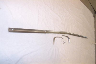

Here is the trim set.
