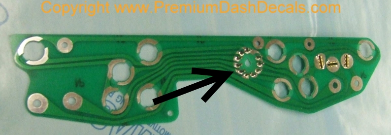

So after taking my entire dash apart, to clean and paint none of the dash guages will work, i looked 100000 times and i cant seem to find what is disconnected. is there a main plug that all the gages go to or am i just missing some little connection. thanks guys.
is there a main plug that all the gages go to or am i just missing some little connection?
Yes there is a main plug, round and it plugs into these pins (ex. 68-70 non rallye):
You have lost your ground add a separate one or locate bad connection
Remember the metal part of the dash it's self is a ground when the cluster mounts to it then the ground circuit is complete. Are you saying you do not see the connector that plugs into the circuit board for the dash? Or your not sure what it looks like?
okay update. everything seems to be connected except 3 eye terminals. i also noticed there are four studs on the back of the cluster, do they mount on to the studs?
