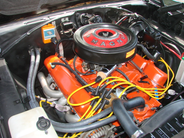

We just finished? bringing a long dormant Daytona back to life at our shop in SoCal for the original owner after over a decade of sitting. The engine runs well at first but stalls out after it gets warm. It had an electric fuel pump that someone previously installed between the mechanical and the carb. We removed the electric but noticed that the mechanical fuel pump on the engine looks like a PEP BOYS special and doesnt have the return port for the 1/4" line going back to the tank. We fabricated a 5/16" hardline to run up through the alternator bracket and around the distributor and up to the AFB along the intake.
Could we be boiling the fuel in the hardline?
We are thinking upgrading to braided line going up to the carb coming from a Carter HO fuel pump to reduce heat and up the volume potential to feed the thirsty 440. Possibly running it to the outside over the valve cover
Any ideas out there?

On my 70 Road Runner 440+6, the return line comes out of the side of the fuel filter, not the fuel pump. Ran it with a Carter mechanical pump in Texas heat and never had a vapor lock problem. PM me if you need pics of my setup.
Did you check your choke pull-off? Have you adjusted your idle air/fuel mixture? Checked for vaccum leaks and checked your vacuum reading cold/warm? Just for fun I'd try swapping a known-good carb off a running car and see what happens. Fuel pressure should remain constant regardless of engine temp. Also, junk in the gas tank will move/be sucked toward the sock the longer you run the car and the more you rev it. Is the tank clean and the sock new? Good Luck!

WHOO HOO! Problem solved!
First of all; thanks to everyone for the helpful hints.
Now for the goods:After each "improvement" we test drove the car until warm to check to see if the problem was still present. As this was a customer car, we didn't want to spend any more money than was necessary.
- Checked the tank and sender sock. - Okay.
- Removed the filter just ahead of the fuel pump. No luck.
- Replaced the "Kragen special" fuel pump with Carter. No luck.
- Installed -6 braided stainless line from pump to carb. No luck.
- Insulated the hard fuel lines from the torsion bar cross member forward. No luck.
- Insulated the -6 line. No luck.
- Wrapped the right side header. No luck.
- Installed the Edelbrock insulating carburator gasket. Whoo Hoo!
Was it just the carb gasket? I doubt it. Probably a combination of everything. At least thats what I told my customer.
