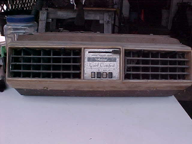

This is the factory 'approved' Airtemp dealer installed unit that came in a 66 Belvedere and probably other models too....notice it only has two vents but it has 4 levers to direct air to 4 different sideways locations. It needs a good restoration but the buttons seem to work ok and the blower works too.
That is what I was describing above and is a universal type that many people put their name on although there were several companies making them.
They blow good cold air when working properly as they recirculate the already cold air in the car. The down side is there is no fresh air coming in the car and after a while the air gets kind of stale. A factory system brings in 20% freash air while recirculating the rest unless you have it on max a/c in which case it shuts off the fresh air.
I don't like the new cars with the 'automatic' fresh air systems. My 66 came with factory in dash ac (that unit above came off another 66) and I ran it on max air to keep the foul air out whenever I went to work and went through a tunnel to get on the other side of the Houston Ship Channel. Besides, most firewalls leak a bit...probably not 20% but still. If I needed fresh air, I could open the floor vent or hit the ac button.
