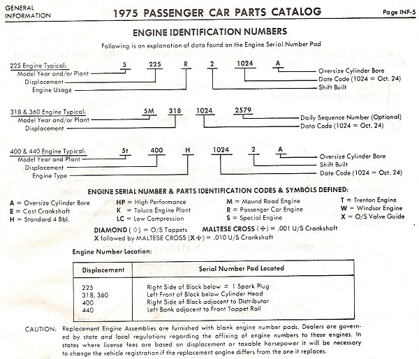

Decode this Block EIC Pad Please
Need this block eic decoded .. 7 T 400 under that is 4 W 19 2 then under that an E Thanks.
This is for 75 but I'm pretty sure everything applies to you. If not, I'll scan the 77 decode info.
