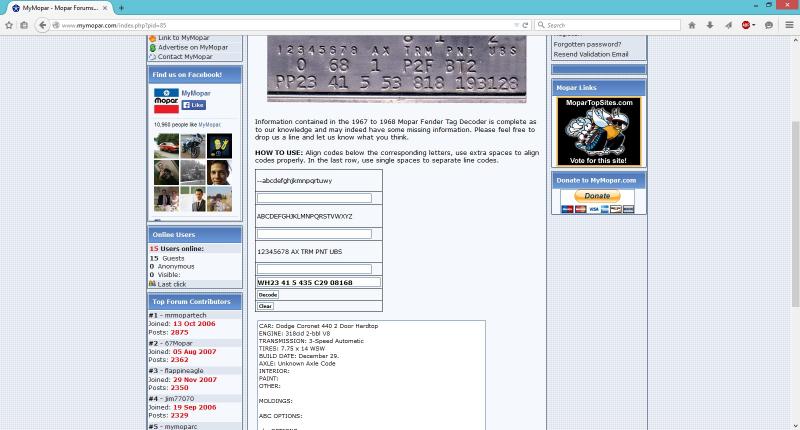

Hey all! Got a slight issue decodeing my 67 dodge coronet 440. The fender tag reads...WH23 41.5 435 C29 08168.
Not like my other 67 coronet,i can decode that one.
Interested in knowing what the 41.5 435 C29 mean?
Thanks for any input anyone can give!

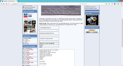

Try this website, I entered your numbers below but you might have to zoom in to see the result!
The groupings are engine tranny tires build. Use spaces between.
e.g. C29 is the date portion

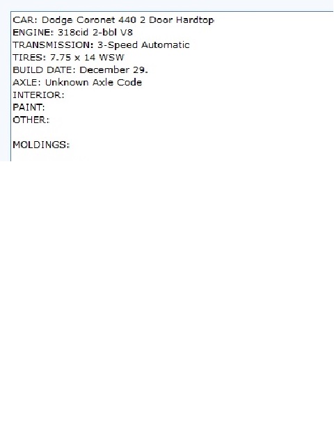

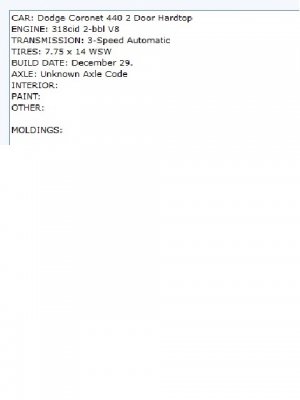

41 = 318 2-bbl engine
5 = Automatic trans
C29 = C is December, 29 is the date, scheduled build date of December 29th, 1967
WH23 = Coronet 440 2-dr hardtop
33 = 7.25 x 14" whitewall tires, 5 = Five tires (you could order a car with the spare tire deleted back then)
5 = Automatic trans
