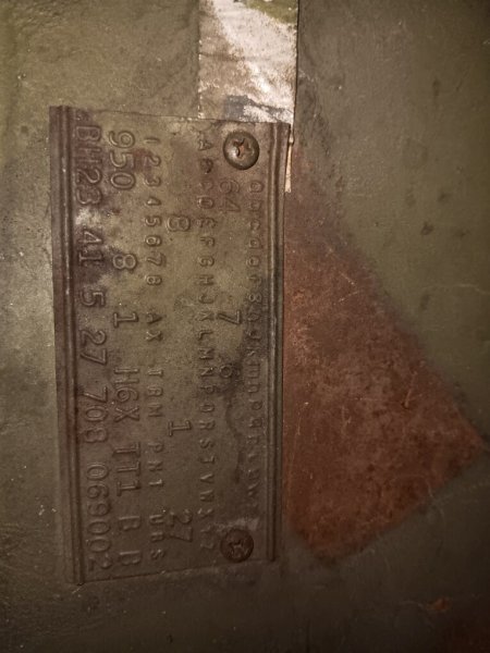

Can someone help me decode the 68 A body fender tag? I’m considering buying it.. I’ve been able to identify some but not all codes.. thanks in advance!
CAR: Plymouth Barracuda 2 Door Hardtop
ENGINE: 318cid 2-bbl V8
TRANSMISSION: 3-Speed Automatic
TIRES: D70x14 White Sidewall
MODEL YEAR: 1968
BUILD DATE: July 08.
AXLE: 2.76 Rear Axle Ratio
INTERIOR: High Trim Grade, Vinyl Bucket Seats. Black Interior.
PAINT: Medium Green Metallic (Dodge), Avocado Green Metallic (Plymouth), Meadow Green Metallic (Chrysler, Imperial).
OTHER: Black (Dodge, Plymouth), Formal Black (Chrysler, Imperial) Upper Door Frame Color. Black Horizontal Accent Stripe.
MOLDINGS:
19: Wide Sill Mouldings
25: Drip Rail Mouldings
30: Body Belt Mouldings
78: Wheel Lip Mouldings
ABC OPTIONS:
E8: Unknown Option
R1: AM Radio
X2: Tinted Windshield Only
Y7: White Vinyl Top
abc OPTIONS:
a6: Console
b4: Bucket Seats
h7: Fender or Hood Mounted Turn Signal Indicators
m6: Driver's Outside Remote Operated Mirror
This all makes sense and explains a lot. The 68 barracuda I’m looking at is a time capsule. Seems to be almost 100% correct. Thank you gentlemen!
