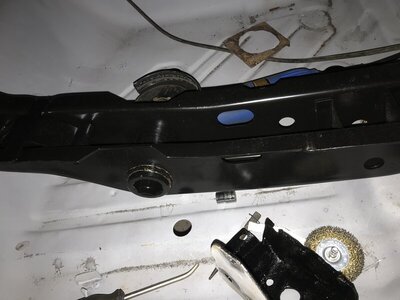

I recently ordered a new tranny crossmember. I noticed it has the torsion bar hex built in it. Must be a different year? Body? Should I just get shorter torsion bars and delete the torsion bar cross member?

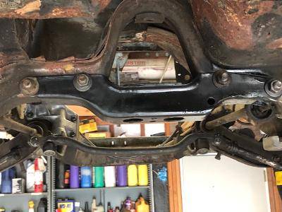

Technically, the transverse crossmember that anchors the torsion bars also has a couple other functions. It connects the left and right rocker panels together AND supports the rearmost end of the transmission. The transmission rests on a bolt in crossmember sort of like the black one in this picture:
View attachment 999957 View attachment 999958

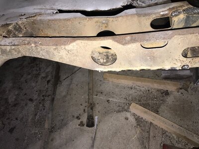

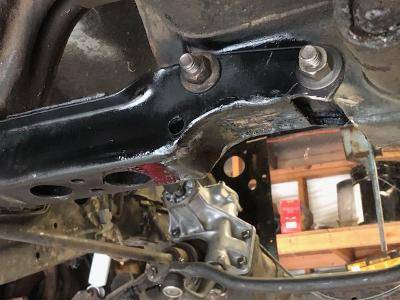

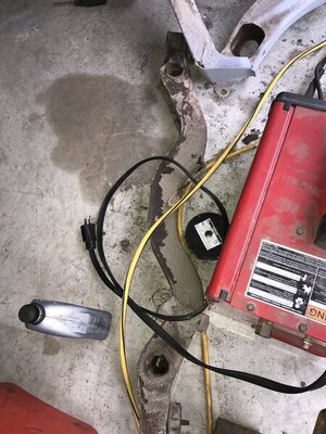

That is the cross member I’m talking about. On my 73 the torsion bars pass through the transverse and are attached to a smaller torsion bar Behind it. I had to replace the transverse crossmember. The new crossmember has the hex instead of holes for the torsion bar to pass through.
81E50401-CDC4-464F-9315-9A1221DC6AC9.jpeg 21D43613-C8CF-4E55-98A4-06BFAFB8519C.jpeg 352A89CB-A8C2-4B19-93FB-976BD12DF968.jpeg
Oh, okay. The 73-74 design is another animal entirely. I'm not at all familiar with those!
The 73 torsion bars are longer than 72 and earlier, and also have a larger hex diameter. There is no easy work around. Get the right part.
