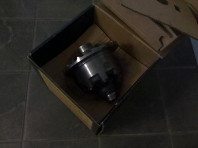

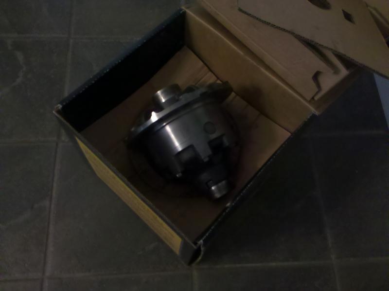

I'm picking one up tomorrow from a guy off cl. Can they be rebuilt or is there anything to rebuild on them, they guy says he pick it up from a rear end place that was there. I know they are a ractching type unit.
Well picked it up today looks brand new got it for $450. Its a 30 spline, no big deal since I have to order axles anyways. Is there that much of a difference between the 30 and 35 as far as strength?
Just noticed the box says 4.56 & up does that mean my 4.10s will work forget how gear ratio are up and down, if I. Can't use my 4.10s is there a way to space out so I can? Just get longer bolts.
Forgot to add the pic

Thanks for your input. Well turn out I think its new, but I have 4.10 gears and the case is for 4.56 & up does anyone know if I can space it out to handle the 4.10s? If not I just ordered the gears from strange and will call them and get some 4.56s

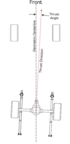

I put a locker in mine too and one thing I noticed is that it highlighted that the thrust angle of the car was off by about a quarter of an inch or so. The rear-end was a little cocked and pointed the car off to one side even when I was steering straight when I got into it and it locked up. They make shims to fix it, but I haven't gotten that far yet.

I called strange this morning it won't work ill have to swap my 4.10s for 4.56s, which they said they can do since I just bought the 4.10s from them. I think they make them for the 8 3/4 I could be wrong.

I don't either, but I'm just going off what the box says. Guess they change the mount for the ring gear due to the ring being wider. Not really sure but hey ill launch harder with the 4.56s.
Was your rear end cocked a little or was one rear tire a bit larger than the other. I got a set of 275 60's off a friend that didn't have a SureGrip and he had worn the right side tire down to about 50% of the left. That made the car want to steer to the right when that 1/2 way worn tire was on the right and steered to the left when that same tire was on the left so I canned them and bought two new tires. Problem gone....
Well I feel retarded, like I said I went off the box but the box was for the electronic locker, we fitted my 4.10s on it and fits perfectly.
