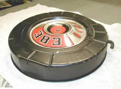

The large one like this?
Does yours have nipple off air cleaner like this one does?
The '68 air cleaners had the nipple to pcv valve; '67's did not. 383 Barracuda's also used this, and maybe 383 Dart's as well. I have a reprint of engineering papers related to the 1967 introduction of the 375 hp. 440. According to these, the 4-speed cars were to receive the large unsilenced. no-snorkles air cleaner while automatic cars got the large double snorkel one. A friend has a 1969 SuperBee. with factory A/C and it has the large double snorkel air cleaner. Maybe Chrysler did the same thing with 1968 A/C cars? I also know of a 1967 GTX. automatic car that came from the factory with the large no-snorkel air cleaner with a Dodge 440 Magnum pie tin on it. A classic case of "What's in the parts bin today?" .

I don't have the original, but would have had a nipple for the PCV for sure either in the can or snorkel

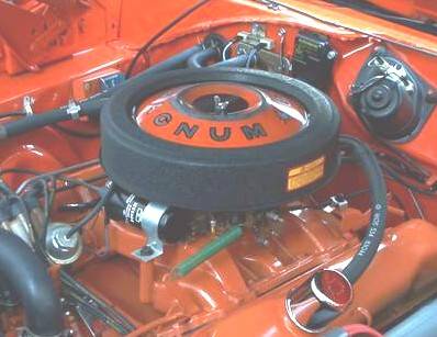

I've seen a 9/67 Coronet R/T one owner car have the large round version, but all the other 440 mags in 68 that I've seen get the smaller one like in post #15. The 68's got the red pie tin.
California did things differently than everybody else in those days (still do!).I wouldn't be surprised to find a dual snorkel on a california car.
Your 49 state car should have a 49 state air cleaner. Like in #15.
