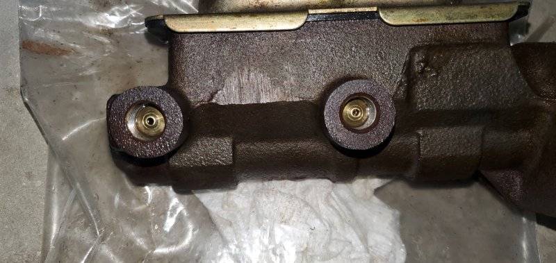

So a few months ago I bought a brake master cylinder at O'Reilly's I'm starting to wonder whether I bought the wrong one. Or maybe defective?
Issue: Flare nut doesn't seem to lock correctly, I have reset it several times and it always leaks, it seems pretty well aligned. The flare nut closest to the firewall is fine.
I went back to the Oreilly site and noticed that they have 2 different masters which are almost identical except for the damn thread size... it seems like that could be it and after some googlin' not sure what the deal is. Or maybe the part is defective and the flare simply can't reach the inside to site flush??
part#NMC11373M I bought this one:​

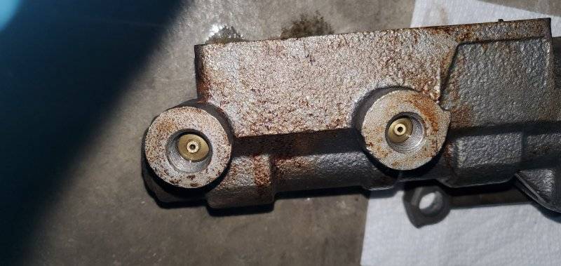

Also the old master is made in USA so maybe I should just rebuild that instead of figuring this out. I may be screwed out of 40 bux since I don't have the receipt for the new one.
Old one, it says lockheed and made in USA:

I think the issue is that the flare did not want to sit, not 100% sure this was the issue. They do look slightly different, you might be able to notice if you zoom in.
New Master:
Old Master:
