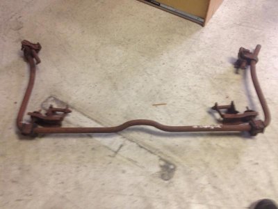

I think so. I got this off of a 66 charger and I found an article on 62-65 b body site that says an early 66 charger sway bar is the same one that was used on a 63-65 b body. Does anyone know where bushings can be purchased for these? Does anyone know what they go for? I haven't decided if I'm going to use it on my 65 or not yet. Anyway, pretty strange looking bar, huh?

yea..that's an early 66 bar....bushing are almost impossible to find....I heard someone makes them, but not sure who it was
Bryan
I used moog part numbers K90599 and K7061.
The k-frame square bushings are a little big in the hole size due to they being for a c-body.
The bracket will need the welds cut so the bushing can be replaced.
Also the bushings for the strut rod will need to have the sides trimmed. I did this on a belt sander.
I posted pictures some where on the web.
