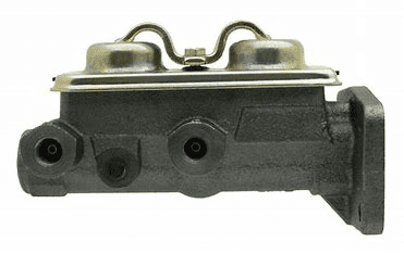

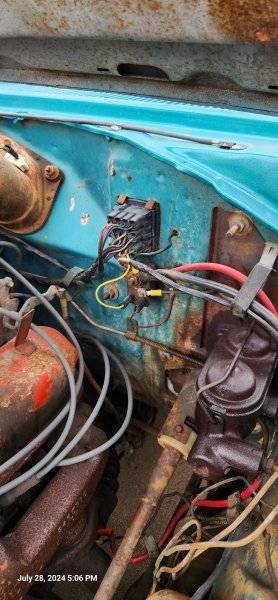

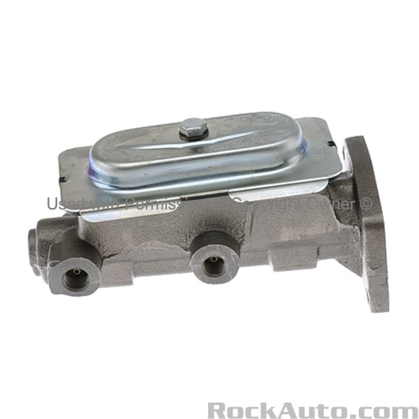

The MC is leaking a bit so I'm trying to order the replacement, whats on the car now has the wire spring thing to hold the top on, but the ones I find for my car at Oreilly's. Autozone, RockAuto and Classic Industries all have a bolt on top.
My car is manual drums all around, if what I have is incorrect can anyone ID from the pics? My main concern is the new one won't bolt up or has the correct threads to seal the lines. Here is a pic of whats in my car as well as a representative of what I'm finding online.
Ignore the rest of my beautiful engine compartment :rolleyes:

If you have manual drums, the correct master cylinder has equal chamber volumes, with a clamp that holds the cover on with a bolt in the middle.
Ok thanks everyone, looks like I have a mystery MC in the car but it does appear to have equal sized chambers front and rear. It stops really well whatever it is. I did just look at it more and it really seems like it is leaking from the lid, the sealing surface is kind of cruddy etc and there are rust particle stuck to the rubber.
