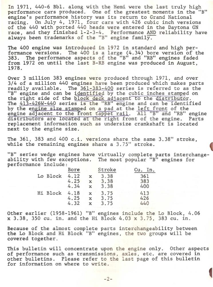

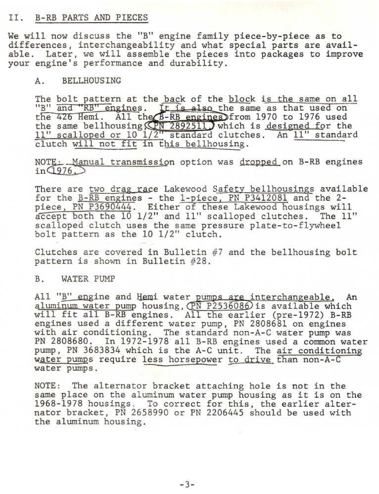

My question is, what is the difference between a B and RB 440 block? Can I swap the internal parts from a 1967 B block to a 1967 C440 HP block is there any difference between these two blocks? If they have the same cylinder bore.
[video]http://www.scribd.com/doc/24470110/B-RB-ENGINE[/video] 2-61ea1a2c90.jpg

Thanks Pops that was a very informative read. Just what I was looking for.
If you mean do parts from a 440 from a 67 B-body (Coronet, Satellite, etc.) swap onto a C-body (Polara, Fury, Newport, New Yorker, etc.) yes, the motors are pretty much the same. Different exhaust manifolds to fit the different bodies, though.
