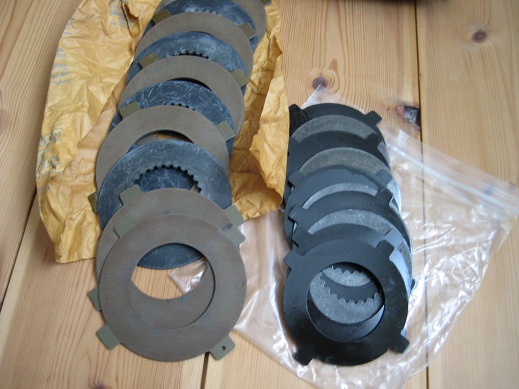

I have new clutch-kit for both Dana 60 and 8 3/4 I can take a picture if you want to see the difference in size between them.

hey 68 gtx. i would love to see the size difference of the clutches if its not to much of a hassle for you take pics
8 3/4 is a Yukon Streetversion sure grip,Dana 60 is a 35 spline 1970 Powerlock

hey thanks 68 . thats alot of good info there. im sure that will help others also. i appreciate it alot
