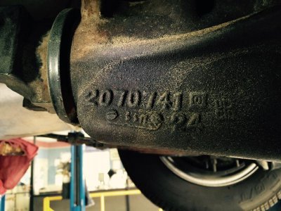

I am changing out my rear gears from 4.10 to 3.55:1. I want to rebuild my sure grip unit but do not know the case. Can someone tell me where the seven digit case number is on a 8-3/4 rear end? Strange Engineering and Moser both advised staying away from a Detroit locker and Auburn posi units.

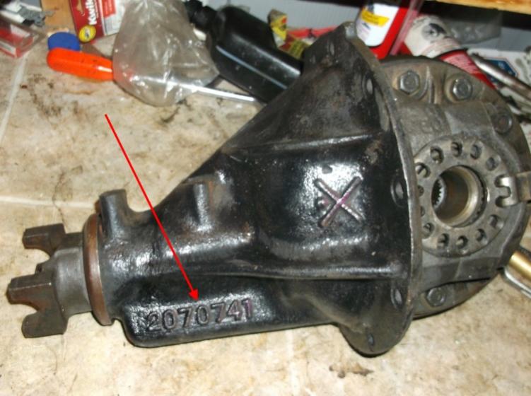

The numbers should be one of these 3:
741: 1-3/8" small stem pinion (aka. '741')>
Carrier casting numbers: 1820657 (1957-1964), 2070741 (1964-1972). This assembly was typically used in low weight/low horsepower applications through low weight/medium horsepower and high weight/low horsepower applications. Pinion depth and bearing preload is set with shims. Differential bearing setting (ie. backlash ) is set with threaded adjusters. MAX WEDGE cars had this carrier.
742:1-3/4" large stem pinion (aka. '742')
Carrier casting numbers: 1634985 (1957-1964), 2070742 (~1961-1969). This assembly was replaced by a phase-in of the 1-7/8" pinion starting in the 1969 model year. 1970 RW (Plymouth and Dodge mid-size) were the last models to use the 1-3/4" which appeared in a 2881489 case. This assembly was typically used in high weight/medium horsepower applications through high weight/high horsepower applications. Pinion depth and bearing preload is set with shims. Differential bearing setting (ie. backlash ) is set with threaded adjusters.
489: 1-7/8" tapered stem pinion (aka. '489')
Carrier casting numbers: 2881488, 2881489 (1969-1974). This assembly was introduced in 1969 and was phased-in to replace the 1-3/4" unit through 1970. Note: the 1-3/4" pinion also appeared in some '489' carriers during this period. By 1973, the '489' was the only unit available in passenger car applications. This assembly was typically used in high weight/medium horsepower applications through high weight/high horsepower applications. Pinion depth is set with shims, preload is set with a crush sleeve. Differential bearing setting (ie. backlash ) is set with threaded adjusters.
Well I have the dreaded 741 case. I am thinking of getting a Moser 849 case with a Eaton Truetrac with 3.55 gears.
I ordered a 849 case, Eaton Truetrac, 1350 u-joint and 3.55 gears from Mosier Enginneering and it should be here first week of March to install that week. I will be selling this 2070741 case along with the 4.10 gears and the Sure Grip differential. I am not sure if the Sure Grip is the clutch or the cone type yet. Any ideas of the value of these used parts where the condition is good as it has worked fine for me the last five years?
