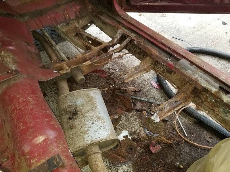

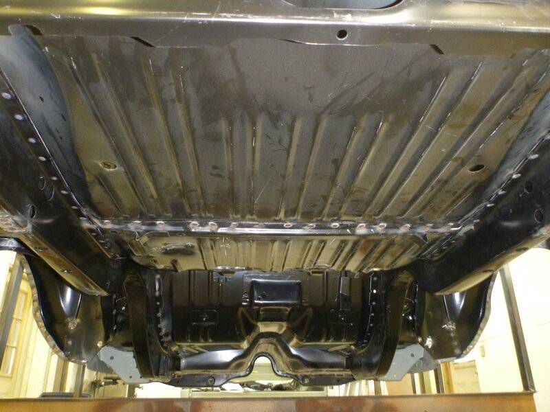

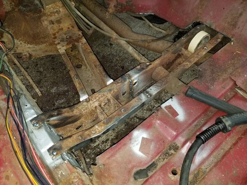

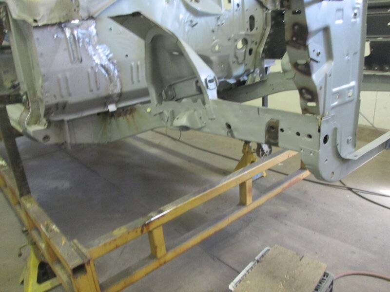

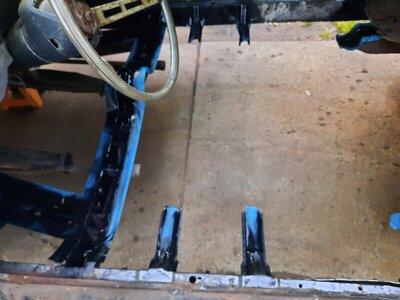

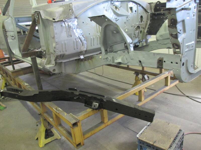

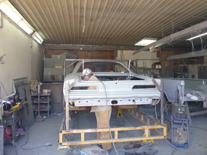

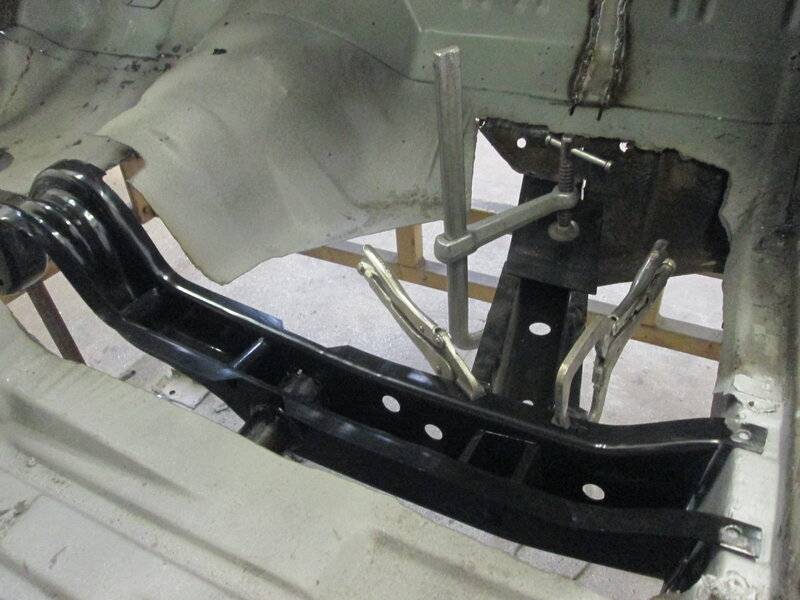

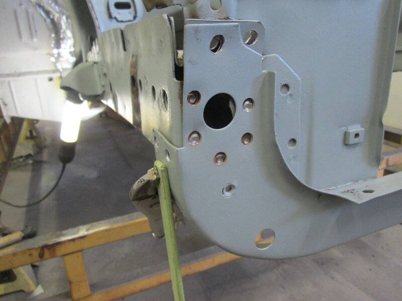

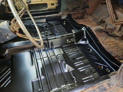

Build a frame jig first using the old alignment pin holes in the frames as guides and go for it. Only way to learn is do it yourself since you say you are handy with a welder and tools. Don't get discouraged because it is going to take a long time and alot of work. I am in the middle of floor pans on my Roached Runner now myself.

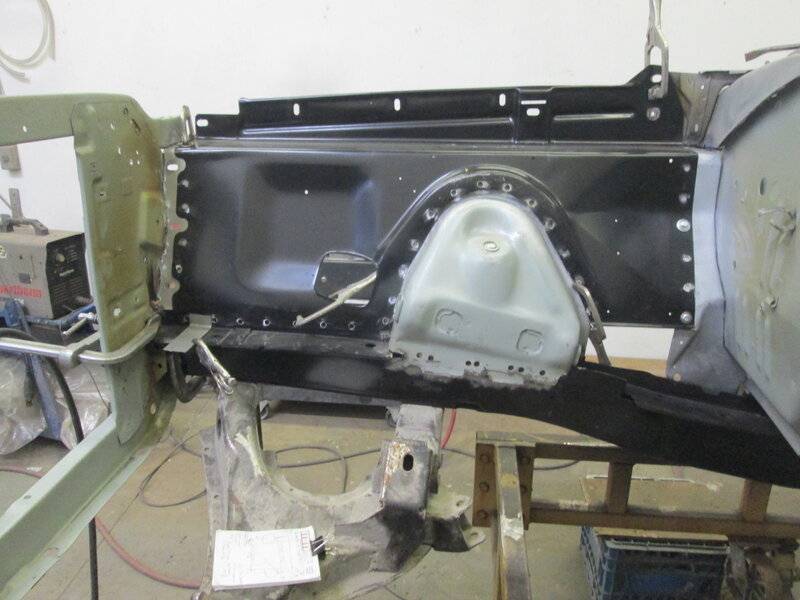

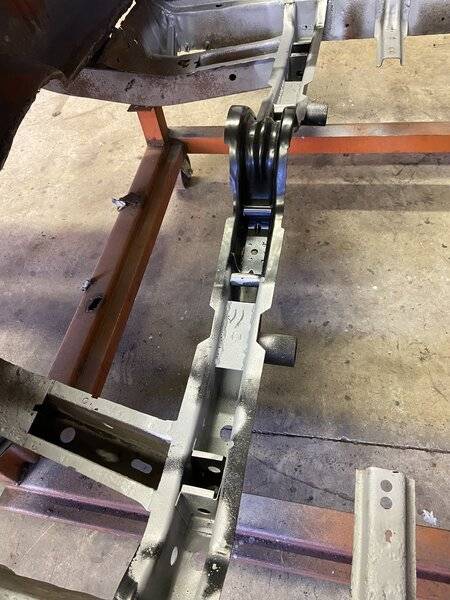

i did both front frame rails on my road runner plus the torsion bar crossmember measure it and do one at a time

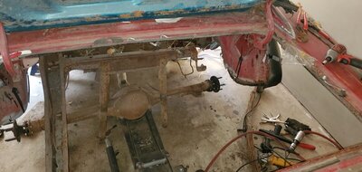

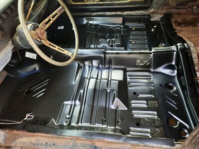

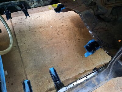

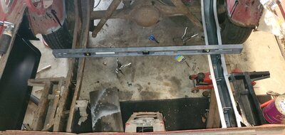

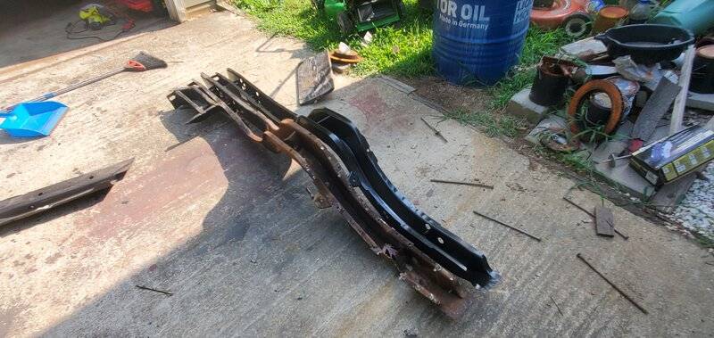

View attachment 1237342 View attachment 1237343 View attachment 1237344 View attachment 1237345
I wholeheartedly agree with this post. His pictures look just like mine!

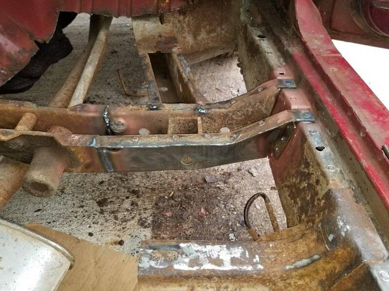

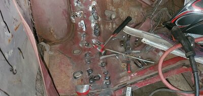

Its not to hard. I had to change one rear frame rail and patch in a part for the torsion bar support.
