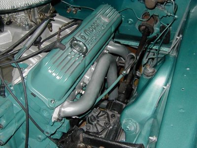

Outside the header tube. You may have to put a slight outward bend in it. I'm using a stock Mopar tube/stick.

Outside the headers...
