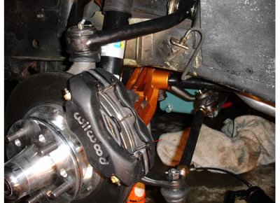

I have a 68 Satellite and needed similar performance upgrades. I just did the Wilwood conversion for the fronts and rebuilt the rear drums. I also read the MA article and did a lot of research. This kit seemed decent for the price and I have seen a ton of them on mopars. The instructions and tech support for a weekend mechanic were not the best.
As soon as the snow thaws in NJ I'll let you know how she stops...

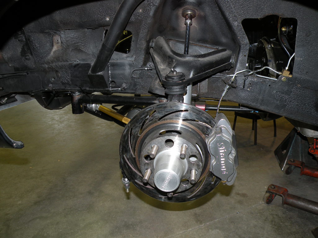

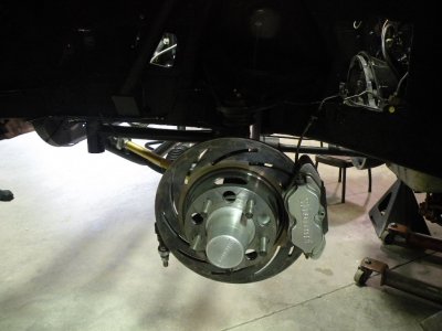

Get the STRANGE front Disc Brake setup. Best out there. Wilwoods Customer service sucks. I'll never buy another Wilwood product.

Jim Buschman
The wear patterns on that disc brake set up look terrible,maybe the rotors are warped alittle but not smooth.I am very happy with the SSBC kit.:munky2:
**Thanks for the feedback Hemi-Itis. I would agree with you that the wear pattern on the Strange Racing Brakes do look bad.........Something's up with that? How long have you had your SSBC Brakes on your 63? Any warpage issues at all?
