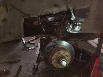

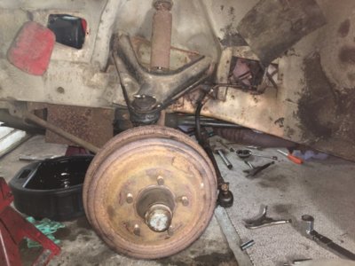

I have a 65 satellite, I went with a stock newer B-Body set up and I took care of a little surface rust. I’m very happy with the results.
FEC41C91-7481-4470-A815-10F3E823A12B.jpeg 23453AD3-1A67-403B-A516-218BD8A4CFEC.jpeg
