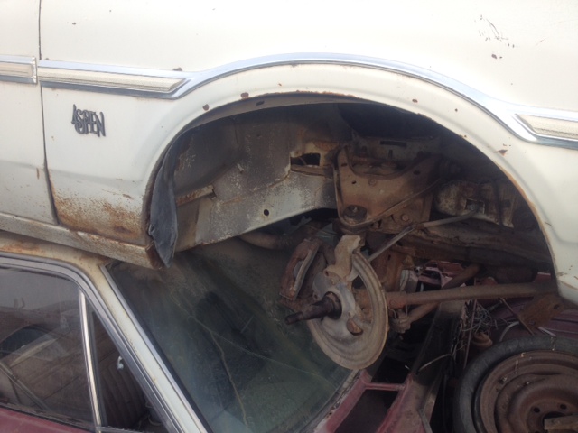

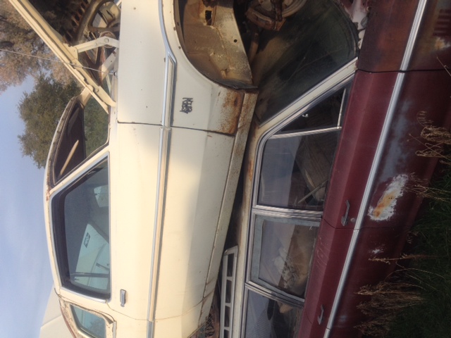

Hey guys, I found this Aspen at the junkyard today. I think this may be a donor car for a b body disc brake conversion?? I don't know what year it is, i didn't climb up there looking for a fender tag.
Ok now I'm reading not to use the FMJ bodies spindle in the mopar action "Disco-Tech" article because they are too tall....so these would be out (if they are what I think they are in the first place).......Am I reading this right? Thanks for the help
That is so B.S.!!!! Use them and don't look back. For the most part, 99%, that article is spot on, but when it comes to the fmj spindles and that article says not to use them, that is wrong for 99.9% of us that have/do use them.
