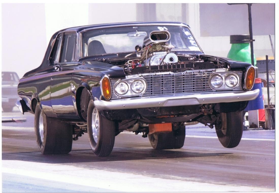

Hi guys, Wondering what may be a good set-up for my 63 dodge, I live in Australia and have seen a few on fleabay....
Whih one sounds good to you educated gents... or is there something better out there for a decent cost?.
http://cgi.ebay.com/ebaymotors/MOPA...r_Truck_Parts_Accessories?hash=item20b0639424
is this a reasonable kit? I still have the drum/drum setup with single master etc.
Any ideas or better prices and ideas would be greatly appreciated.:)
The MOST reasonable cost is the Scarebird conversion stuff. He sells brackets and a "parts list" so you can get the calipers etc anywhere you want. Uses (forgive me) off the shelf GM brake parts, and you can do both front AND rear discs for less than about $600 total.
I was going mid 10's @ 128 MPH with 6 cylinder front drums:blush:I went to SSBC for their basic kit that comes standard with 4 puck calipers.The kit fit on my 6 cyl spindles and comes with EVERYTHING you need for an easy install.http://www.ssbrakes.com/commerce/br...=(L) 4 Piston Front Brake Kits
FJM disk spindles (75) 73+ A body hoses (25) , 77-80 FJM Calipers & Pads (50), Dustshields (30), Rebuilt Drum/Disk MC (30), new prop. valve (90), Rotors (70), misc bearings/seals (50). ~$420. All mother Mopar parts. easy to get and install.
spindles attach as stock to you lower and upper BJ assys.
1) Nice car! 2) Mid 10's at 128 with 6-popper drums? You,sir,have large berries:yes:.
Oh, Santa Claus...can I get in an early request for next Christmas? I'd like some good brakes...
Sounds good.........but I'm on the other side of the planet...is there anywhere that may stock all of these parts so I can get them all at once and they may be able to ship to my guy in Cal.:)
