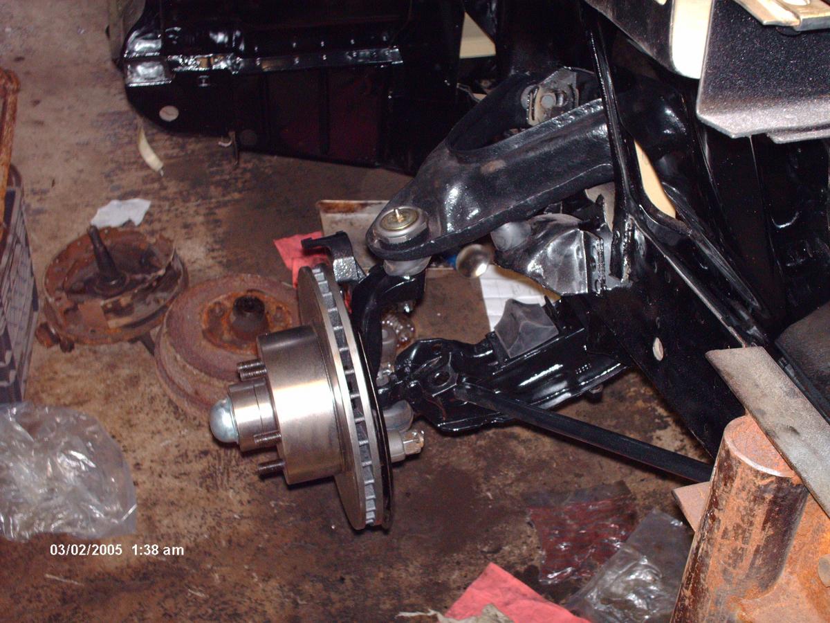

I have a 72 Charger that I just pulled the disc brakes/spindles/proportion valve off of. I am hoping to use these on my 69 Coronet. I am having trouble finding info on if this swap will work on my Coronet. Do I need to change out the control arms or just the spindles? Will this swap even work or am I using the wrong doner car? Any help would be appreciated.
I used stuff off a 73 charger on my 69 Roadrunner worked great so far.
Thanks for the info guys. The breaks on a 72 and 73 charger are different and thats why I wasnt sure. In the pic your calipers are on the rear of the wheel (unless im looking at the pic wrong). In the 72 charger the calipers are on the front of the wheel. Hopefully this doesnt make a difference.
If your 69 car has the factory sway bar brackets on the control arms they will interfere with the front mounted calipers. Otherwise no issues.
