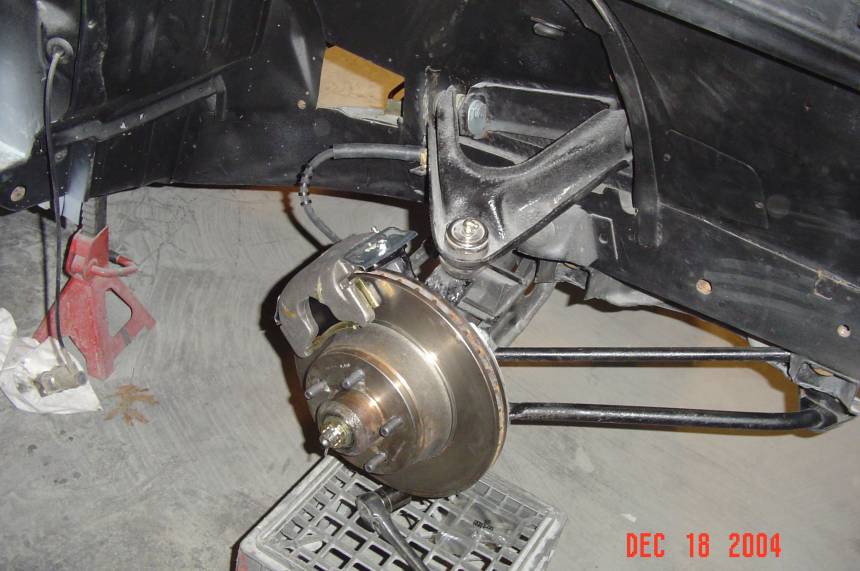

what did you use for your swap?
Thats the MoparAction swap- 76A body spindals, 11.75 Cordoba's, volare hoses, they are reverersed to accomodate the front sway bar. All replacement parts, except spindels, are available cheap at any parts store.
That's the road I'm taking.
by reversed you mean swapped left for right?
Yeah, the spindles will work either way but make sure your hoses are clear and don't bind. Also you want to make sure the bleeder screw is on top.
