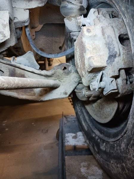

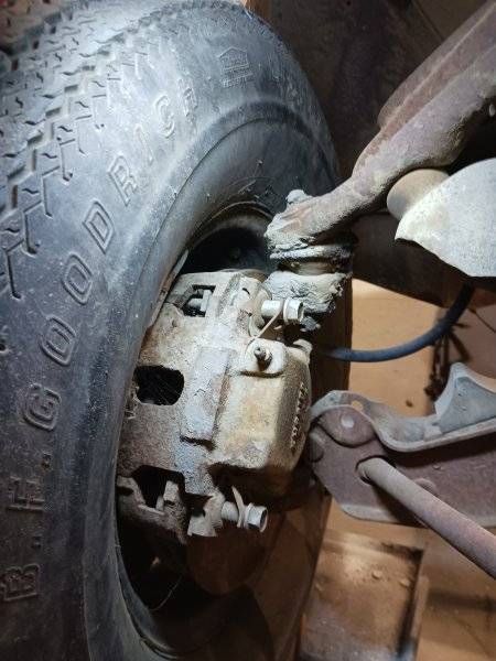

Never saw this on any car and that Is how this car has them. Any one else? All cars have calipers on rear of front spindle. Looks like that is how it is made. On my 65

Disc brake swaps (Disco-tech) using Mopar parts from other years had issues with hose routing due to where the hose attached to the caliper. Front mounted calipers solved the routing issue. But on pre-70 B-bodies the calipers would interfere with the sway bars. There are still hose issues if you try rear mounting the calipers. I'd like to see a couple photos of the OP's setup.

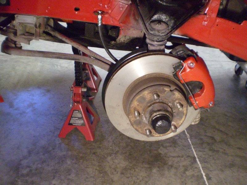

Original 72 Challenger calipers. Driver's side and passenger's side photos show front mounted. The photo of the passenger's side of my 74 Charger show rear mounted caliper.

When converting an early B-body from drum to disc brakes, with the calipers hung to the rear, it is a fairly simple job to move the brake hose bracket from behind the top control arm to ahead of it. Just drill the spot welds on the bracket, move it ahead on the frame, and reweld through the holes. This way, you can use a factory hose.

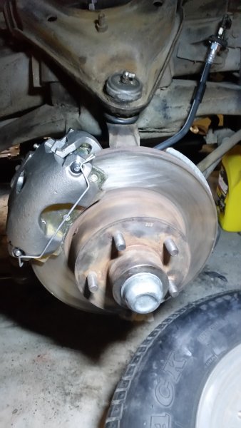

1965-72 A body Dodge Darts, Plymouth Valiant's, Barracuda's, has disc brakes on them, and they are mounted towards the rear.
They are Kelsey Hayes, 4 piston calipers.
I mounted mine to the rear to avoid replacing the hard lines, hose routing has not been an issue.
