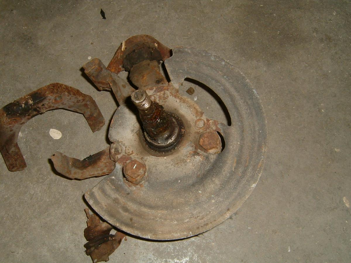

Hi new to the list and was trying to convert my 1970 road runner to front discs, i had a list of parts, but my first problem i ran into is that the rotors i was to use have a 115mm bolt circle instead of the 4 1/2".

1. is there a rotor that will fit these spindles (attached picture) that have a 4 1/2" bolt circle? (also would like to i.d. these spindles-as i got them at a swap meet)

115 mm is 4.520" so I'd say it's pretty darn close, or close enough. The 70's vintage Toyota trucks accept 4.5" BC wheels and I bet they are 115 mm.
The spindles look like the later slider type but make sure they use the big bearings.
Your existing brake booster should be fine if it's in good shape.
You can use an adjustable proportioning valve or get a nice clean one out of the wrecking yard from a mid size front disc car.
Offset bushing??
