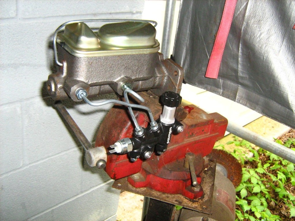

Once you got away from factory stock, the "correct parts" no longer work and should be just viewed as a guideline. Mainly the adjustable valve will help set the rear pressure lower then the front so that they don't lockup. I do use that adjustable valve from Wilwood and that master cylinder type for a 4 wheel disc setup.
2014-08-07-1 Coronet master and lines.JPG picture is for 65 Coronet using disc-drum cylinder.
View attachment 413623 picture is for 65 Coronet using disc-drum cylinder.
Thank you. I am somewhat confused however, as I thought the front - small reservoir, and large - rear reservoir were rear and front, respectively. What is the MS from ? Do you attach the MS to a power brake booster as well ? Thanks again.
SSBC kit for power front disc on 65 Coronet. Big reservoir to disc and small to drum. With adjustable valve disc get full pressure and drum are reduced pressure. Wilwood valve removes all other connections, on most setups you will have to make custom lines, only buy steel coiled rolls and add the Summit gravel guard. That way is the closest to stock appearance. I like the 3/16 tube bender Imperial 364FH for tighter bends.
