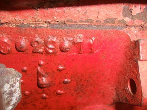

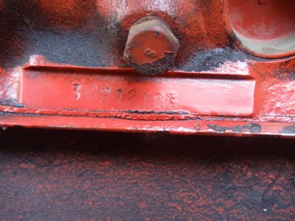

According to the advertisement, my recent 340 purchase was supposed to have been a 1971. Casting date is 8/71 or 9/71 (hard to read) and according to serial number on the oil pain rail it was assembled for the 1973 model year (first digit is "3").
Yep, the VIN is for a 71 model year car. Also, the first digit in the serial number stamped on the front of the block... is a "G". That confirms a 1971 model. So, I guess the block did sit on a shelf for 16 months. Looks like yours too, Dibbons. I guess it happens.
