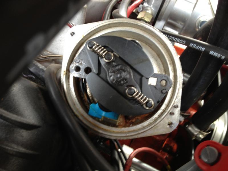

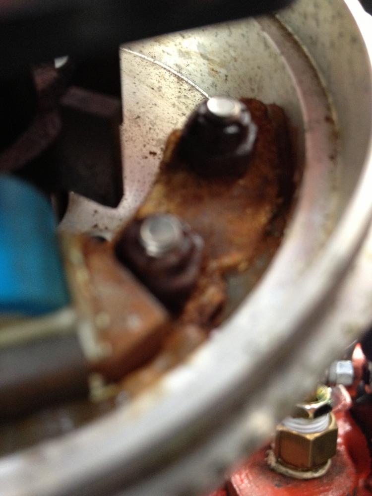

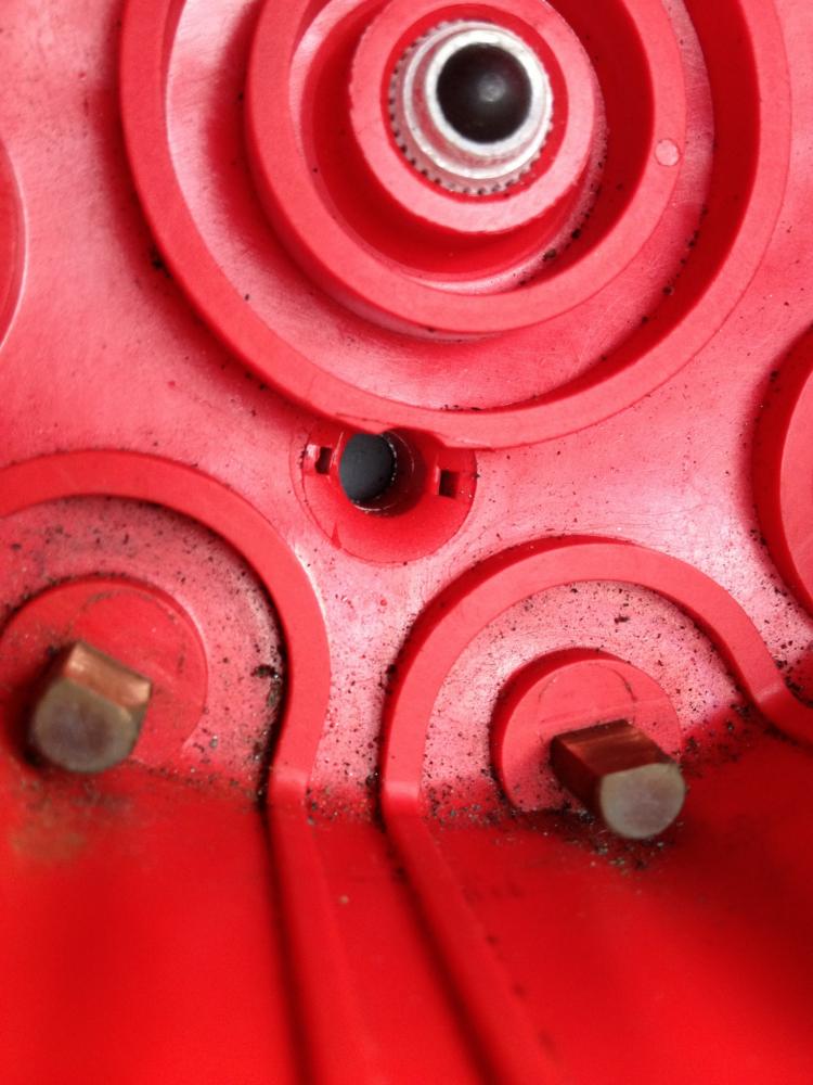

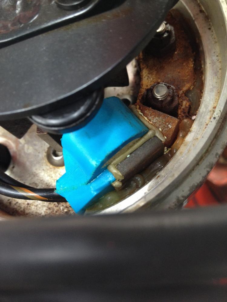

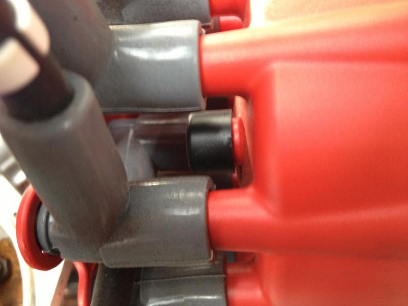

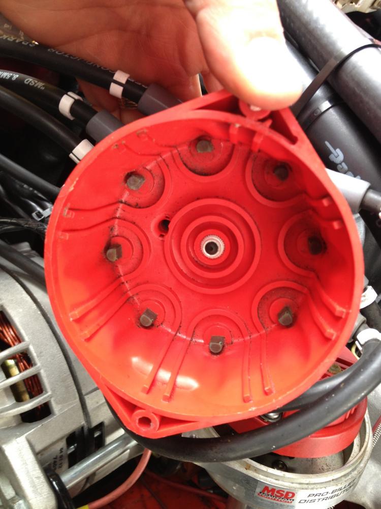

Here are some pics i took today. I noticed a small hole in the top of the cap that had a black plug. Do you know if the plug can be removed to allow the excess ioniztion to escape?
Blow the inside of that cap and dist. out with some compressed air. You have a bunch of residual 'debris' left from when your mechanic 'cleaned things up'. Is your hesitation a misfire or maybe an accelerator pump in the carb gummed up?...if it stumbles, but quickly recovers, then I would be looking at the carb. Ol' racers will say: Most electrical problems tend to be fuel related, while most fuel problems tend to be electrical related...
Good luck with the troubleshooting!
Looks like those two lock nuts are rusting up and causing rust to get everywhere. I would begin by taking it down, cleaning everything up good. Then replace those two nuts with a couple of stainless lock nuts. If the piece they hold down is rusted as well, clean it up and paint it. Be careful though. It MAY need to be grounded on the distributor body. If it does, make sure to leave the under side unpainted.
