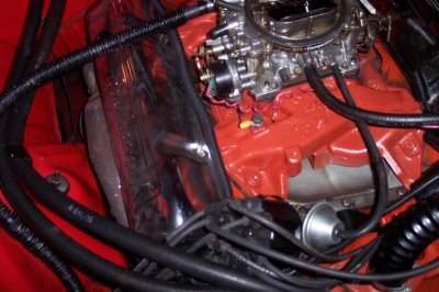

No reason to get nasty, I'm the one that didn't add the correct information. Go figure I forget to mention the most important information. It’s a 1969 Road runner 383 4 speed magnum, also see attached for exact location of oil leak. I really need help with this; it’s a pain in the ***.

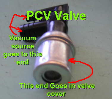

do you have a PCV valve in one of the valve covers? if so, check to see if it's plugged

This past Wed. when I had the car out (and stepped on it a little) I returned home, lifter the hood and saw the PVC Valve was out of the valve cover, I guess it was blown out. The one that’s in the car now only has 1 end on it on top, not 2 as your photo shows.
My vacuum is connected to something else.
That could be your problem then. There are two typical ways to evacuate crankcase pressure on a stock car. One is the "breather" mounted in one or more of the valve covers that allows pressure to vent to atmosphere. The other is the PVC valve that actually uses engine vacuum to pull the pressured gases out and return them to the intake. If your PVC valve popped out (from pressure build up) it could be that it was plugged and not operating correctly - or maybe that the vacuum line pulling on it was choked off (same effect).
Either try soaking the PVC valve in gas to get it clean - or just buy a new one, and make sure the vacuum line (s) connected to it is pulling a vacuum - into the intake.

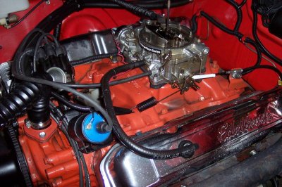

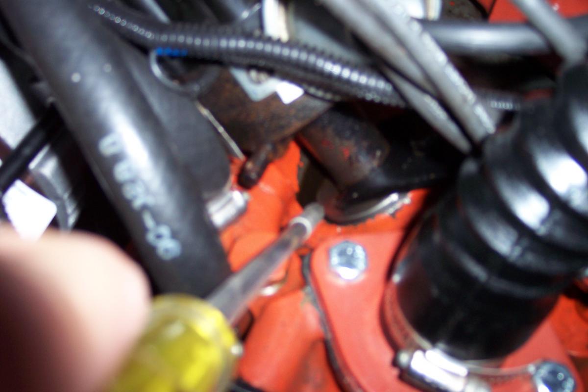

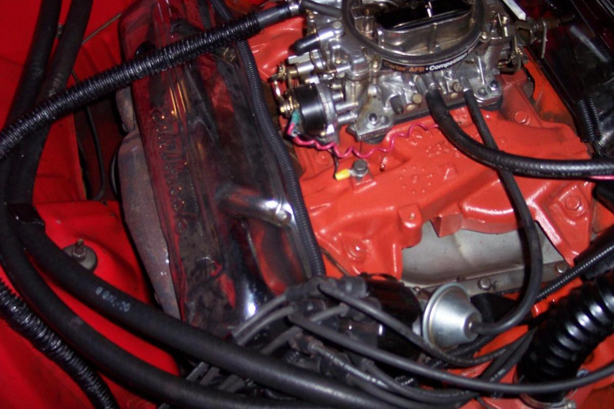

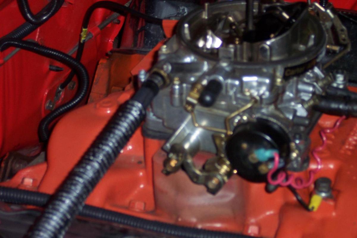

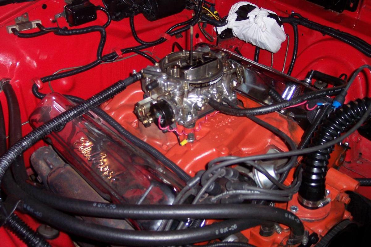

I also attached more photos for you to look at, maybe there’s something out of place?

From what your pics show your engine looks like it only has a PCV and not a crankcase breather. If you replace or clean your PCV and still have the problem try a valve cover breather, you can get the type that replaces the oil fill cap .Your engine may be creating more pressure than can be relieved by the PCV alone hence the pushing out of the PCV and the oil seeping out of other places. Does your oil dipstick push up in its tube?
Thank for your help, this $%#* thing is turning out the be a disappointment, but I guess its part of the package. I have a breather (on top of the carb) with a hose that runs to the oil cap, so I have that covered. On the issue with PCV I’ve replaced it but not with the one that sicksatellite posted with a photo on 22April. If I can find one like that where does the small top opening hose hook up to? Also, yes the oil stick comes out as well as the PCV (from the valve cover) and oil from under the distributer. I took the car out yesterday and it’s still leaking, that was after replacing the PCV and cleaning out the oil valve cover breather. I would really hate to have to take the car to someone to correct; I need to keep trying on my own.
