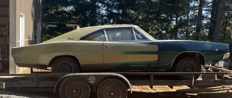

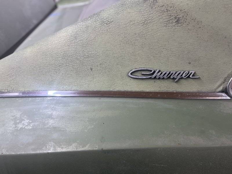

Just starting to restore my 68 Charger RT and trying to collect as much information as possible. It is an unmolested car purchased from the 2nd owner so I can see with my own eyes what is here, but I don't know how many options there were in terms of vinyl top colors/choices. At one time I thought the choices were black, white or green but all the green vinyl tops I've seen are much darker than mine. Body color is TT1 medium green and you can see by the photos the top is much lighter. I think the bottom line here is where and how do I purchase the correct vinyl top?
This car was sold when assembled so ordered by someone with some fairly odd combination of things.

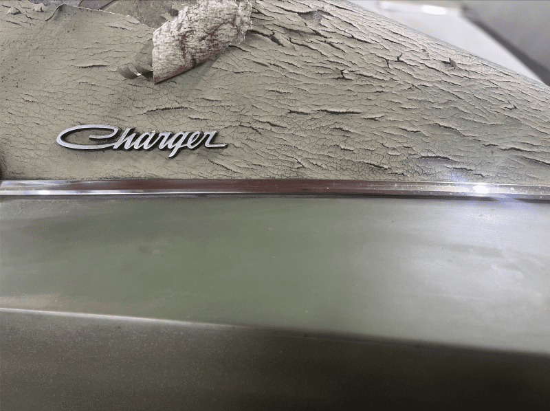

It looks faded to me too. Remove all of the trim and see what color you see.
Just clarifying, what would be odd about green/green/green or what combinations are you talking about?
LOTS of dealer installed vinyl tops back then... I did many.
Build sheet also, I would think. Looks white to me. Was picture take indoors? Out door photo in sunlight might be better. Hows the condition of the metal part of top.
The entire car is pretty much rust free. The top is in really bad shape, but the car spent most of it's life driving really fast a quarter mile at a time.
Under y is a 4 which indicates green top. I think is 68 there were only 3 colors available. Green, White, Black.
Thanks to all who replied. I guess I was confused by the light shade of the top. Using Chargervert's mom's 70RT photo as an example, see how dark her top was compared to mine?
