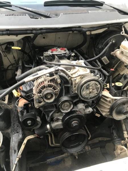

Out with the old 5.2
In with the 5.9 Just have a few things to button up and she will run tomorrow..
Yup bolted right up. The torque converter was not weighted but the flex plate on the 5.9 was.. So its all good just need to bolt up the torque converter, exhaust and put the radiator and hoses back together and it should be ready to fire up.
