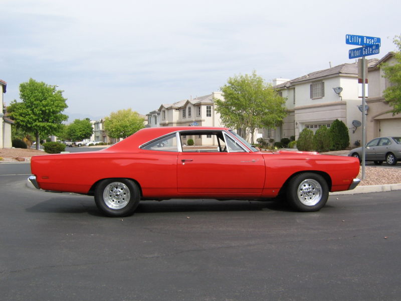

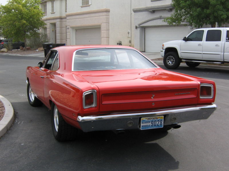

68bee70rr Sorry I'm no where near there either, it looks to be pretty nice though, not very many photos of the car to critique' from, has he sent you other photos ??, like the trans cross member where the torsion bars attach, of the trunk floor or underside of the area under the rear windshield, of the corners under the front windshield, the lower quarters behind the rear wheels & the edges of the rear wheel wells, the front fenders behind the tires on the bottoms, the front floor boards, the cowl with tons of leafs etc., issues usually because of old dried out leaky rubber seals, leaf accumulations & rock chips, all those areas are also very prone to rust {if you didn't know that already}.... Also Las Vegas is a "really dry area" of the South West, if the car originated from there, it could be a very good, nearly rust free car, being a RR BB 4spd., I'm sure it has been run hard & putt away wet, most all of it's life.... Good luck & Happy Moparing meep meep $22K is about the right money...
From what I see the car is located in boulder city which is a distance from LV. My advise i to find a appraiser and pay him the money if you don't find somebody that lives there.
Looks like a great car Brad, I think for that money someone you can trust to look it over good is a good idea, I know you know all the areas from your projects, that i hope is going well! Hope you find someone, good luck.

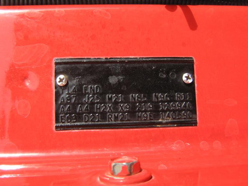

69redrunner i posted a pic of fender tag he sent me.
The car is actually in North Las Vegas, not Boulder City NV. The guy who put it on ebay for him lives in Boulder City.
Well,
A4 paint code is Silver Metallic
J25 is 3speed wiper, which is correct for an air grabber car
N85 is dash tachometer
N96 is air grabber
D21 I believe is 4 speed
H2X is black bench seat
R11 is music master AM radio
So, according to the references I have,(paul herd roadrunner, charger, superbee restoration guide) the car has been painted and should be silver.
Does the last 6 digits of the vin match the numbers in the fender tag?
Maybe some other members can add more insight.
