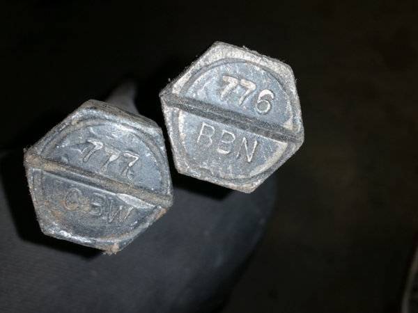

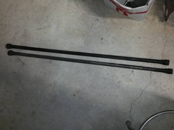

Here's what I've got . . . the ends of the bars . . .
Is there some other numbers on the bars that I can look for ? ?
Hmm..don't know. They do have paint spots/stripes on them for left and right.
.88 in. Dia.
You can get bars up to 1.220" dia. A set of .960" dia.
Should be about right for normal driving.
