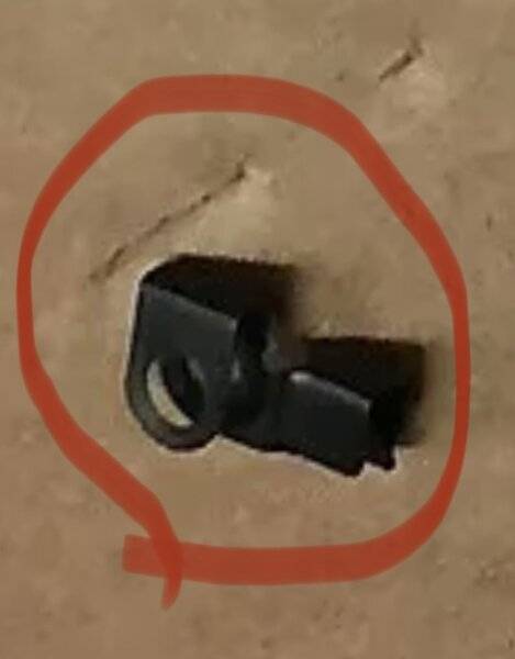

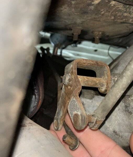

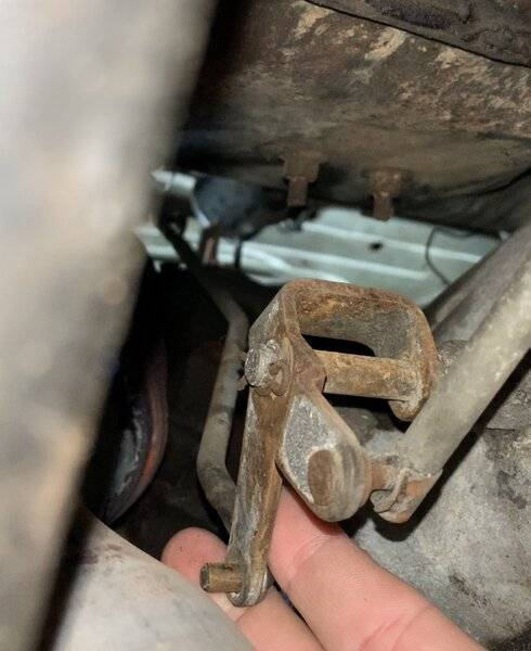

My dad and I just bought a 1969 Plymouth GTX with a 440 and an auto trans. The lower section of the kickdown linkage is missing its clip. Does anyone know what the clip I need looks like? I bought one on eBay, but it was the wrong one. No one seems to have one.

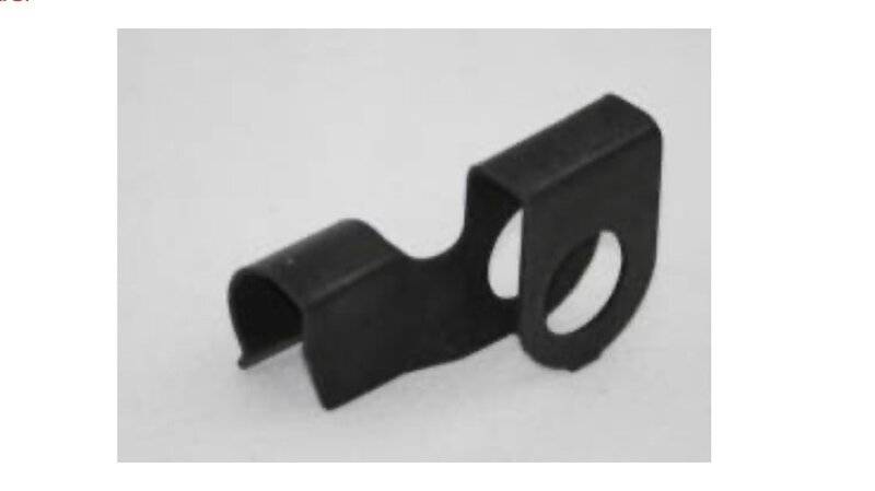

That’s great guys, but which one do I need? The eBay and the website are opposite each other.
From what I understand, it's a left-hand and right-hand clip. Does anyone know which of the two I need?
Still need help guys. Bought one from the guys at mrmoparts and they sent the wrong one. Does anyone have one. And does anyone know if it’s the left hand or right hand type? Thanks

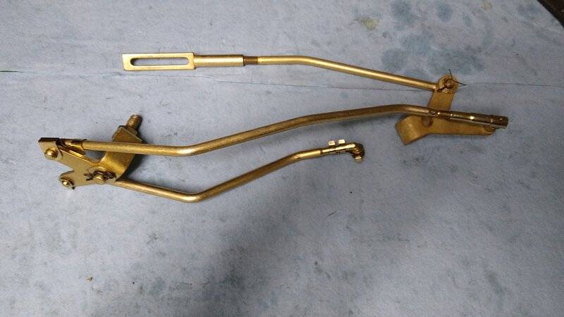

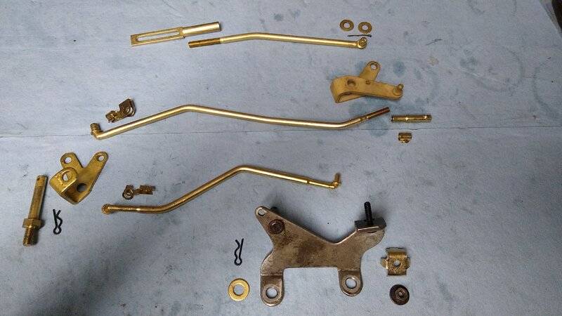

Here pictures of mine:
Napa sells a throttle linkage kit with 3 different sizes of left and right. I believe u need the 1/4 inch right. 7 R Its stocked there. It’s like $6.00. Kim
