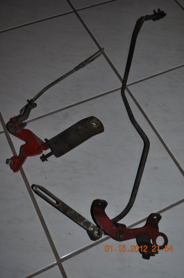

Does anyone know what mopar linkages this is?

Any help would be appreciated. Thanks, Brad

they look like kickdown rods. im not sure though.
im sure a more experienced member will chime in. Guys?
One on the left is part of a 66-70 K/D linkage
Black braket in the middle is for the auto console shifter. Mounts to the tranny and hold the main shaft.
Right one is a 71-2 B/E K/D linkage. Not sure what motor. SB, BB 2-bbl and 4-bbl are different.
top one is big block 2 barrel. bent cable clamp portion also. again 66 up
