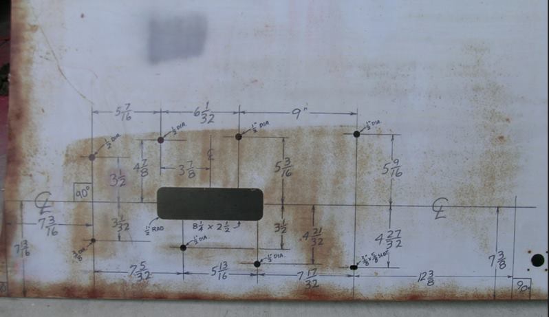

So is there truly any difference in a stripped down n96 hood and a coronet (flat) hood? In otherwords would that work on a Bee if metal were removed from the coronet hood?
you can cut out the two holes for the scoop and mount the scoops, airbox on a flat hood. Here's an a picture someone shared of the measurements. I've not done this yet to mine, but probably will. Someday.
Good question. I've thought of this but I don't know the answer. I've looked at the hoods on Coronet station wagons and convertibles and they appear to be flat 'Superbee' hoods. That's hardly an answer which I'd like to know.
