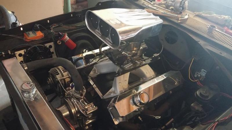

if you look at a manufacturer like proform,just for example,they list the same billet base plate for 650 through 800 cfm carbs.the main bodys are individual for each size carb.i build franken carbs for my motors and have done tons of mods to holley carbs with great results. 10411292_237489503112653_6391885681296785854_n.jpg
current project has one on it.
