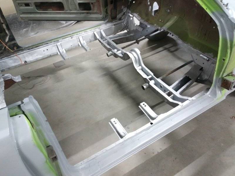

70 charger. I’ll be cutting out the old floors and welding in a new one piece floor with rear footwells.
I could do it leveled on jackstands, it’s just a much bigger PITA with my current work space.
I think you will be fine doing the work on the tires, as long as they are all the same size and inflated to the same pressure.
Mike
rockers and roof hold it together.......if those aren't rotted, put it on jackstands or tires and letterip
The lack of an engine means it sits higher up front. I doubt it sits level. But everything else looks solid. I’m hoping it’s stiff enough to roll it out to cut the old one out, fit the new one and weld it in over the course of several days and still be able to keep it inside.

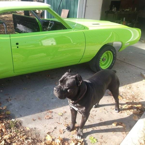

you're fine rolling it in and out.....this one was a roller
bolt on the doors and line them up prior to welding if you're concerned........pretty sure one of the doors has to be removed to get the pan in the car
this is the same car........all welding was done prior to removing suspension, then it went to the rotisserie
