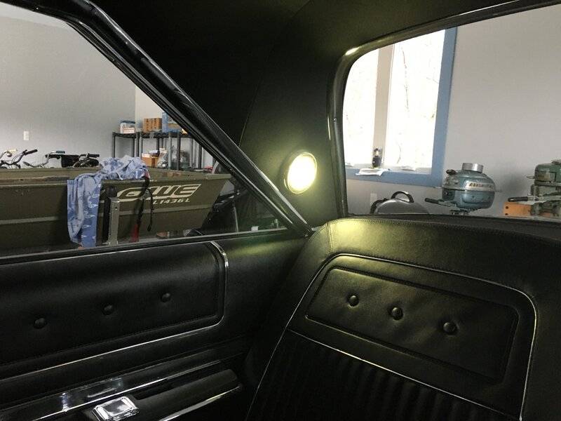

We bought new sail panel lamp lenses and I didn't want to install them with the original style 1004 that would just cook them yellow anyway. I found these LEDs on Amazon (hope it's ok to show the link) and they stay cool and are very bright and fit perfect in the little housing behind the lens. I removed the link but they are called Makergroup 1142 and they were about $8 for a pair.
You can add the link as it helps direct members to what you are wanting them to look at.
Just search makergroup 1142.
