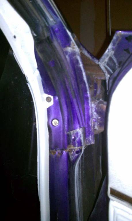

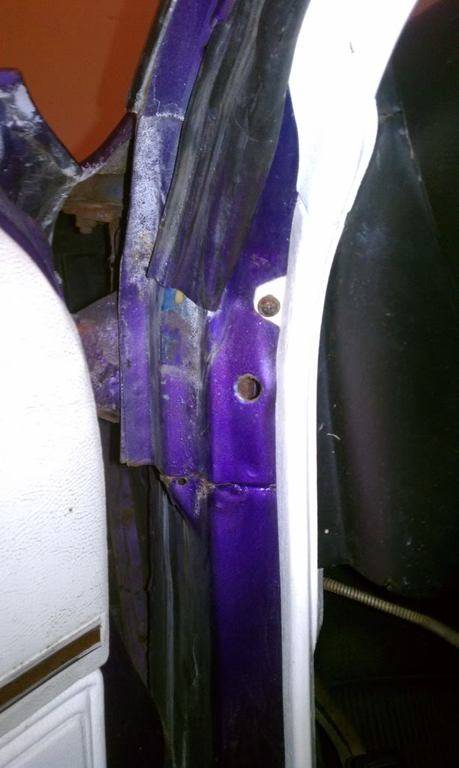

When I had the metal work done on my car, the guy didn't redrill the holes for the dome light switches on the A-pillar. I was wondering if you guys could get a good pic with possible measurements of where to drill for both driver's and passenger side. Thanks for the help.

Give me just a minute and I'll take some pictures of mine.
Passenger side;
Drivers side;
Hope this helps.

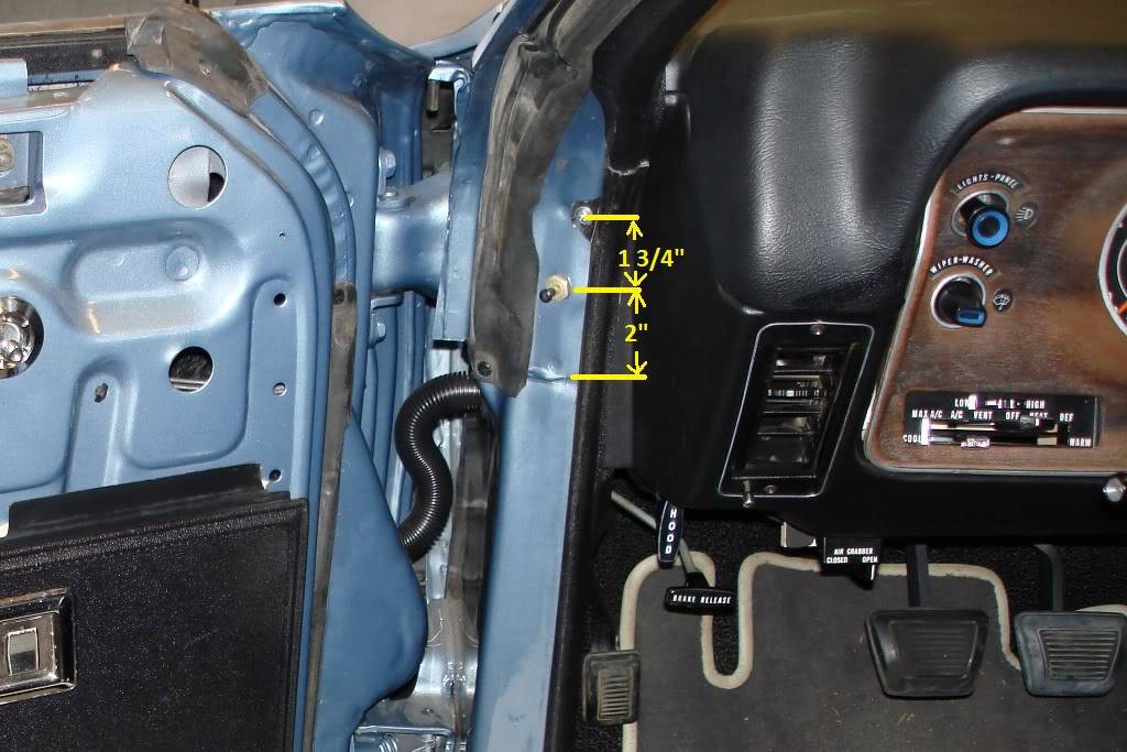

How far above that seem is the hole drilled? Thanks for the pics.
I'll head out to the garage and take some meaurements for you in a bit. I should have thought to place something there for reference.
Thanks for filling in where I left off! I got sidetracked for a little longer then I planned, and you always seem to come through with the good detailed info.
