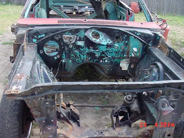

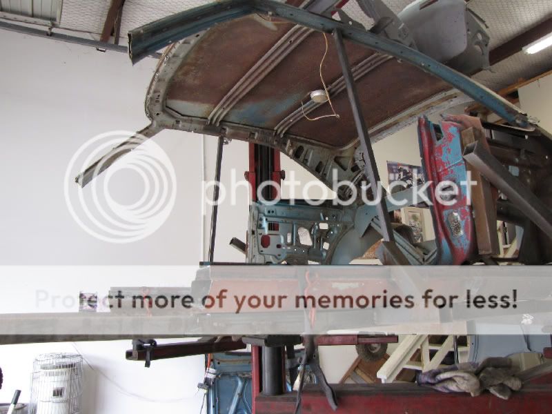

Tearing into it revealed a nice Q5 original color!

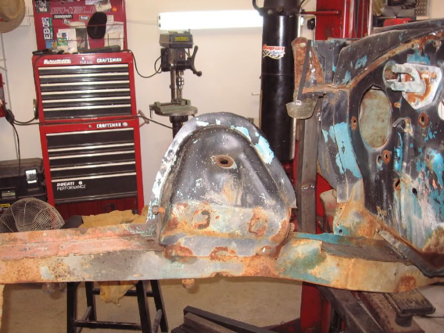

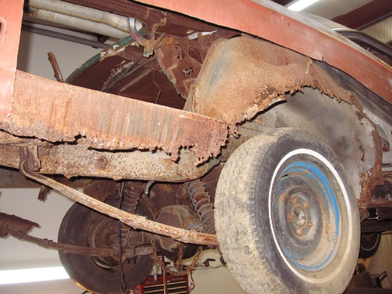

But, also revealed a horrendous condition this car suffers from, lots of abuse and neglect, when the floor is compromised, and let's in salt spray from RI roads, it's over Johnny!
Got it tore down, built an external skeleton to hold it together, fitting new frame rails
Tearing the front out/off, find out the firewall is too damaged to fix, out it will come!

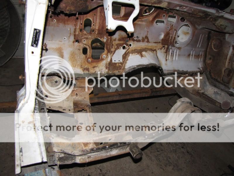

And this will go in it's place!

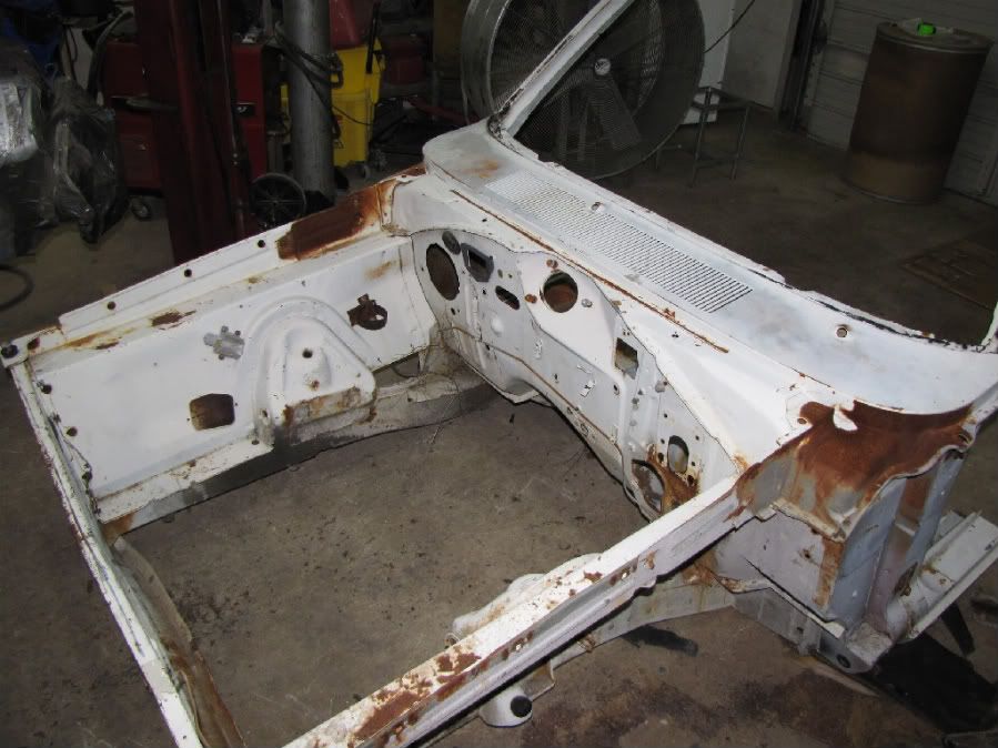

Thanks ya'll! I've got my AMD list of new metal to acquire. So, my Media Blasting operations powers my restoration progress, so, any inclined TX folks out there, give me a holler so I can send that order in, things are slow these days. In the mean time, I am carefully and surgically cutting out the front end, and prepping the donor piece for an installation. This is big, and critical to get it 'right'! More pics coming later in weekend.
Today was cut short...my daughter called me up asking me to take her to the Mall! However, I did get the entire front end removed from the GTX, man, it's a scary sight to see nothing there, I mean nothing! I did get the new front clip hoisted in position; now, it's cut/fit and fabricate it to fit on the structure. I'm cutting out the remaining floors in the donor clip, well, not cutting them out, I am cutting 'em out via drilling the spot welds, don't want to hack stuff up! Took some pics, will post them tomorrow.
As promised...floors removed (what was left of them). I did this to see better the underneath structure, and, I have new floors to weld in (of course). I'll get this front clip welded on, and reinforced, then move onto the rear frame assy. Then, when it's a complete frame system with floors, and frame reinforcements I will Media Blast it on my rotisserie.
Got the white clip mounted up, and tacked in place, took about 30 different measurements on all angles -- glad I have the Satellite to use as an example! Ran into an issue...not surprising, the outer rocker panel on the donor clip is a different shape than the GTX, so, I sliced the old ones off, and sized up the old outer GTX segment.
Further along in the white donor front end clip, got it all welded in, about 75% complete. Had to fashion the rocker panels, as the white ones are wrong for the GTX. I cut out the face, and welded in the good GTX parts, and made some work from the cut-out white clip rockers. Lots of welding today, lots! I'm going in behind perhaps tomorrow, or, Monday and weld in some braces behind the weld seams to strengthen it up. I have not welded the A Pillars together yet, still pondering that little adventure.
Got the A Pillars done! The right one is not 100% straight, it has a little bend in it (first one I did). I think a little hyrdaulic ram action will be in order as it may need to move about 3-5mm. The left one is straight and came out MUCH better than the first one. Again, I forgot my camera and had to use my cell phone...when I ride the Ducati to my shop there ain't no room for an SLR camera! I will take some better quality pics this weekend. Notice the rocker panels; major surgery with the old GTX originals as the donor was/is different.
