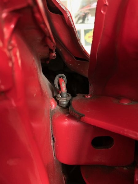

The roller door check is worn out and does not hold the door open. Is the a repair lit out there or does anyone have a repair process to corrrect this problem.

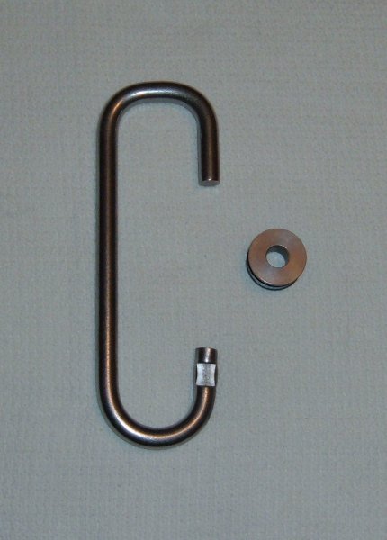

The spring and roller need to be replaced at a minimum. Most likely the ramp on the hinge will be damaged and needs to be reground as well. we recommend a hinge rebuild. we do both doors, top and bottom for a member price of $209. Pm me if interested
